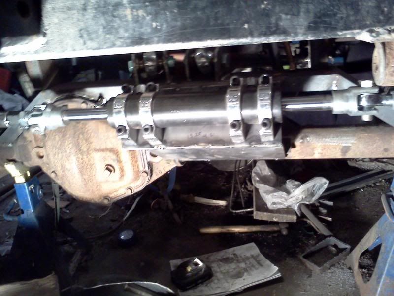

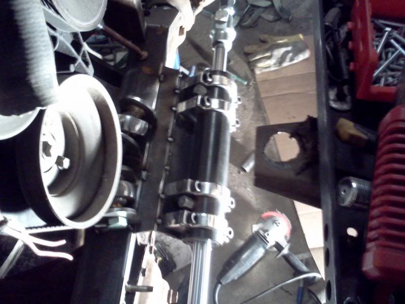

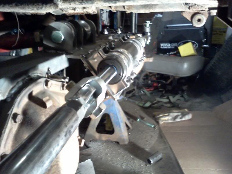

2.5x8 double ended ram works great
his is sweet i used a 2x8 it was worked but not as good as the 2.5x8 double

mudbuster do you have any pics of how it is mounted? is a double ended faster? because my obital and a 2x8 ram it is 1 rev of the steering wheel lock to lock.. so i was going to use a bigger ram to slow it down some...
