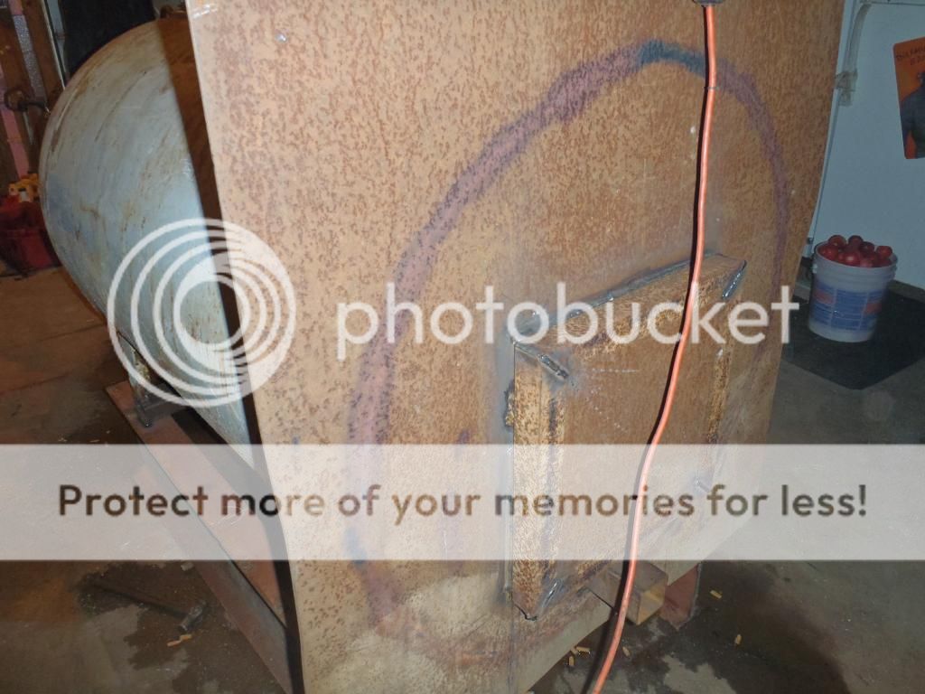

[url=http://i889.photobucket.com/albums/ac94/Big_Frank_2010/2014-10-09170926_zps2750851d.jpg][/URL] ive been working on this all week just about done  gotta make the hinges for the door and a latch   holds around 280 gallons of water  should keep the house and more importantly the barn warm this winter

theres one tank inside  the other  all recycled  material  minus  torch gasses and welding wire/rod

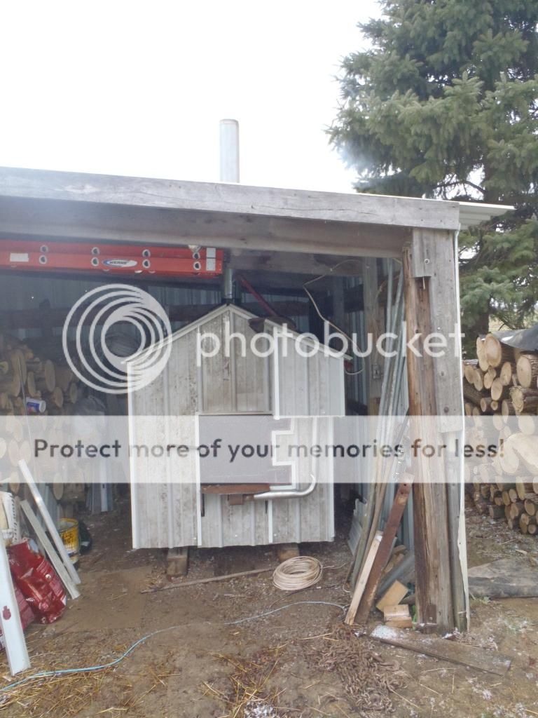

made a shed/housing around  it  with some metal studs and steel siding  12 inches of r 19 insulation   and 6 inch foam roofing   insulation in the walls and roof  works awesome  got  it all going yesterday  putting whole unsplit pieces of wood in  and  got about 11 hours of burn time   the best part is  I haven't heard the gas water heater turn on  applaudd

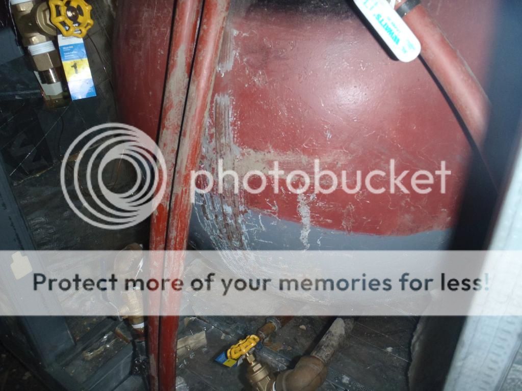

     its basically a water heater  firebox is surrounded  by water that is pumped into the house threw a heat exchanger that is plumbed into the house water heater then the heated liquid is circulated through 1/2 inch pex tubing in my floor  I gotta change something tho its 89 degrees in the house
