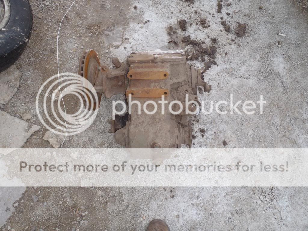

I  knew  what ya meant  lol  but ive seen a couple people flip the whole axle around     I have a extra gm-1 t case  ya don't have too weld anything just a bolt in the range selector rod  too keep it in 4wd   could run the  th 350/ 205mated into that   no messing with flipping the axles
jimmy101
   hmmmm   lots of choices .  thats a good thing.   350/205 into military t-case..... very do-able.   Soooo..   instead of a two wheel drive trans...it would be better to just add a military case? What do these things weigh?
pretty close too what a  205 does

Big Frank  ??????????????  You have me thinking about this two case idea. For the weight gain I am not sure how much I would benifit  from doing this.   also 4:1 seems too low.  idk  I think I would be better flipping the  chunk and running a regular t205.
