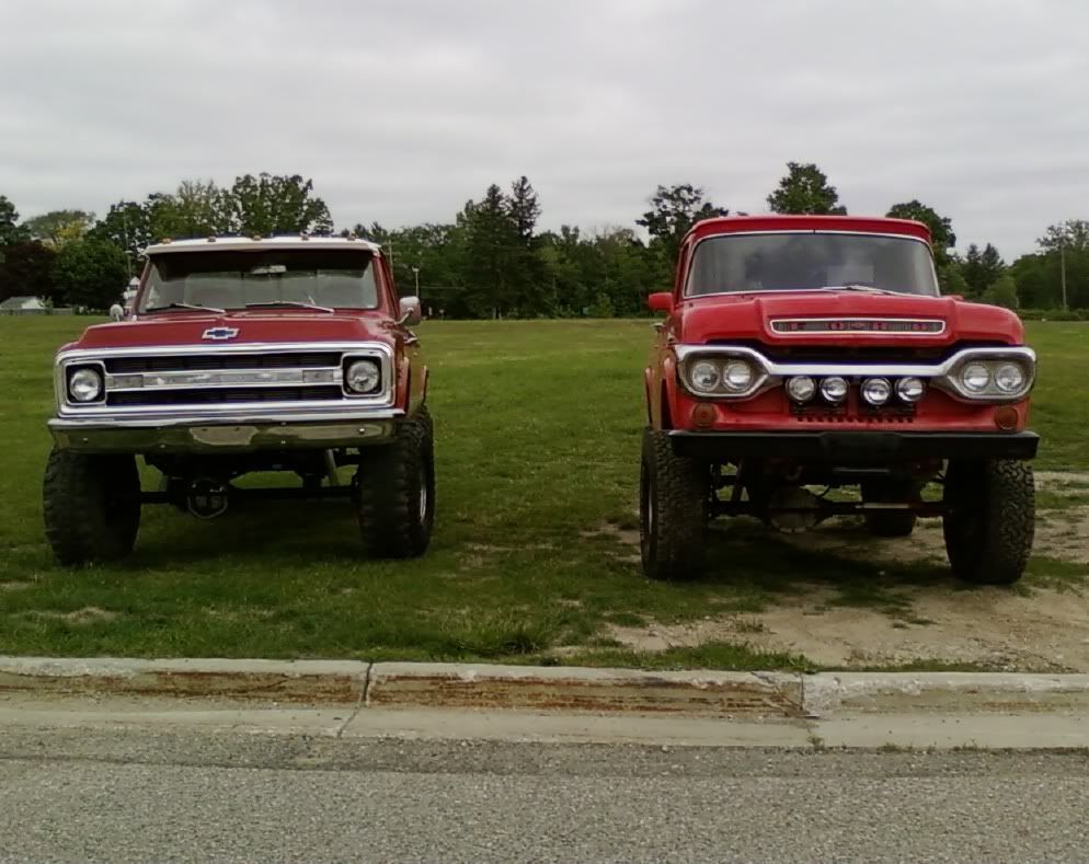

Mine and my friends truck parked at school today.
madkmart
that is so awesome those trucks
 ==kp bad you let friends drive fords though j/k loll
ROCK
lol i know, kind of have to let it slide since its just a ford body and everything else besides the body is chevy. ford tough with chevy stuff. he calls it half-bred.
