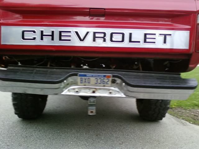

got rear ended by a dodge 3/4 ton cummins. bent my hitch like a pretzel and so it was about a foot off the ground, sheared bumper bolts, bent the last 2ft of my frame all up.   ==censor just glad it wasnt either of the cars. i was sitting still waiting to turn and he was going 35mph not paying attention.
quick fix and off to prom
