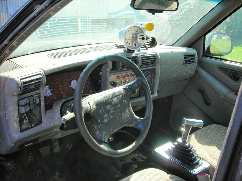

love my push button start! all my fuses are right by my switches too! i will get pics  for ya tonight.
thats how i run it, relays and everything :)

i even have lights to indicate power! can see a little bit of the fuses and p00
