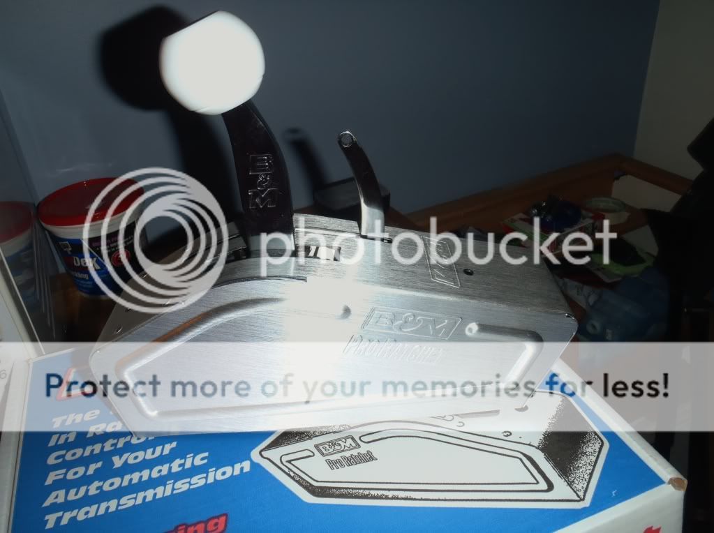

chompin at the bit waiting for my new shifter should be here today  via ups    did however get a d shaft loop put in between trans and t case  its real close to the shifting rods for t case and didnt want em to get tore up if a u joint fails

yup moves and no leaking  lol   have to get a alternator  now  turned on the fans and it smokes the belt  and isnt charging  also going to go back to a mechanical fuel pump i dont think my regulator is working properly   shifter is all mounted and works smoothly  ==wgm     and the frustration level is way down also  ;D ;D ;D ;D ;D ;D
