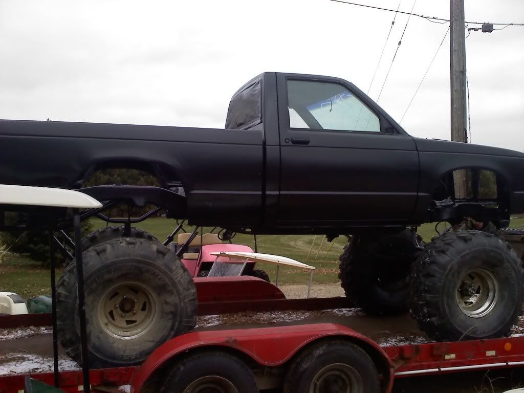

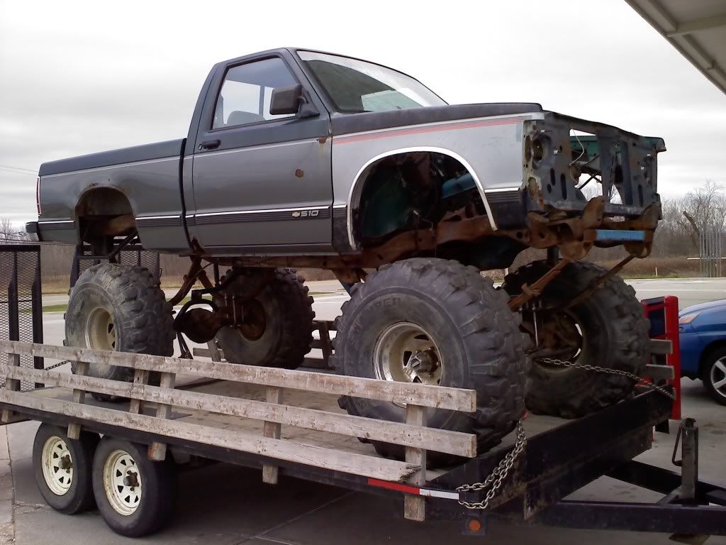

well me and my buddy bought this s10 a few days ago. it is a 92 on 42" tsl super swampers. here it is on her way home.
it has a engine in the pic but we have to return it. so we have no trans engine or t case. it has stock cj 7 axles but we have a dana 44 for the front and a dana 60 for the rear already.

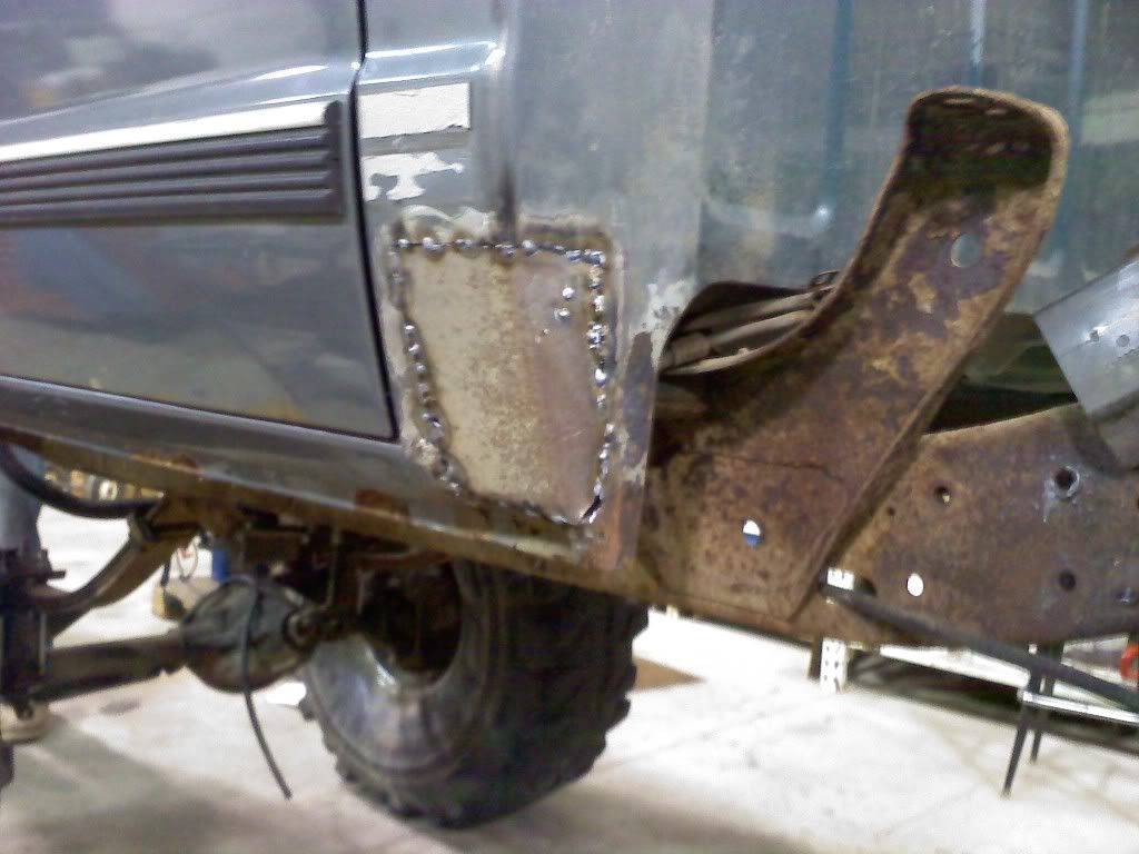

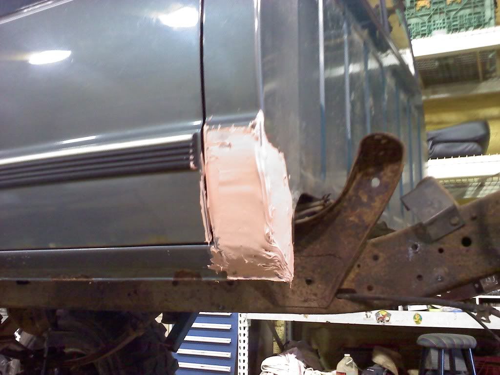

we plan on putting in a 350 small block and a 700 trans. so the other day we started fixing up the body on the truck so we can get it painted.
i think we did a good job for only being 17 and never doing cab corners before we still need to sand the bondo and the rest of the truck.

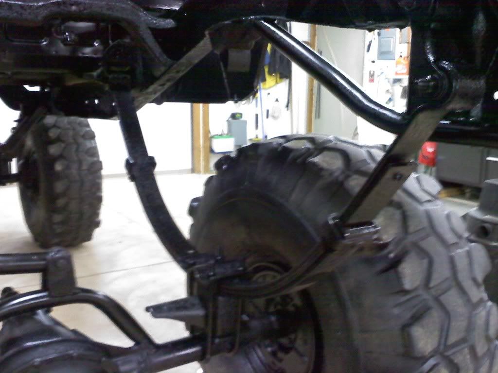

look at those rear leafs!!!!!!!!!!!

not bad ill give ya a tip dont let that bondo sit as soon as its sandable start the sanding cause if you let it dry all the way its like sanding concrete. Good luck on the project great idea nice to see your doing something productive.
Foster Creek Mud Runners
dfm_13
well thx but i already waited to long its been a few days and i was gonna sand it tommorow lol......i was lookin forward to it untill i red that lol

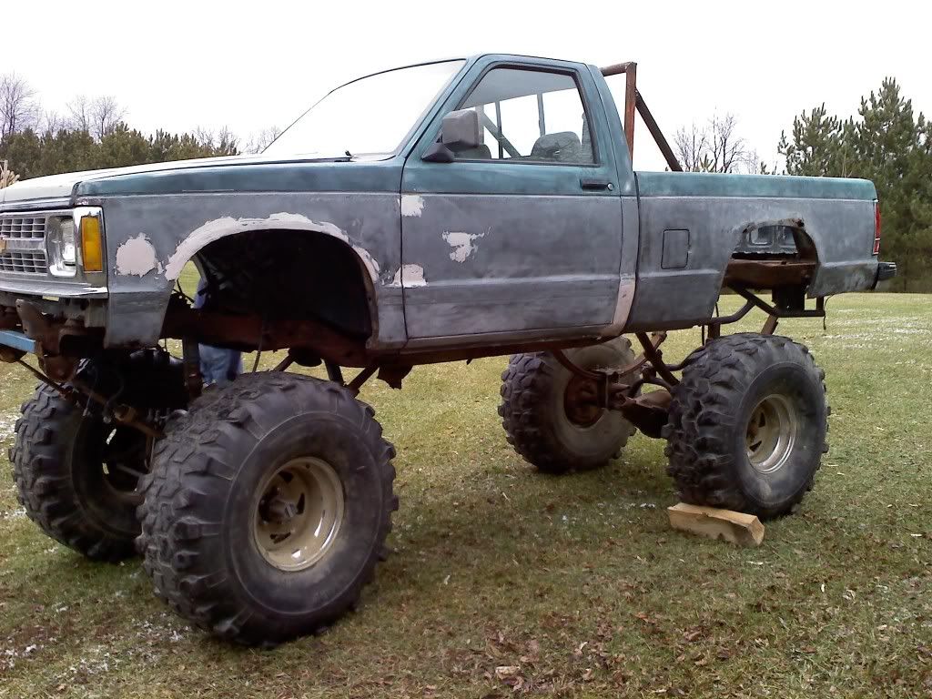

alright so i have a few really big updates.

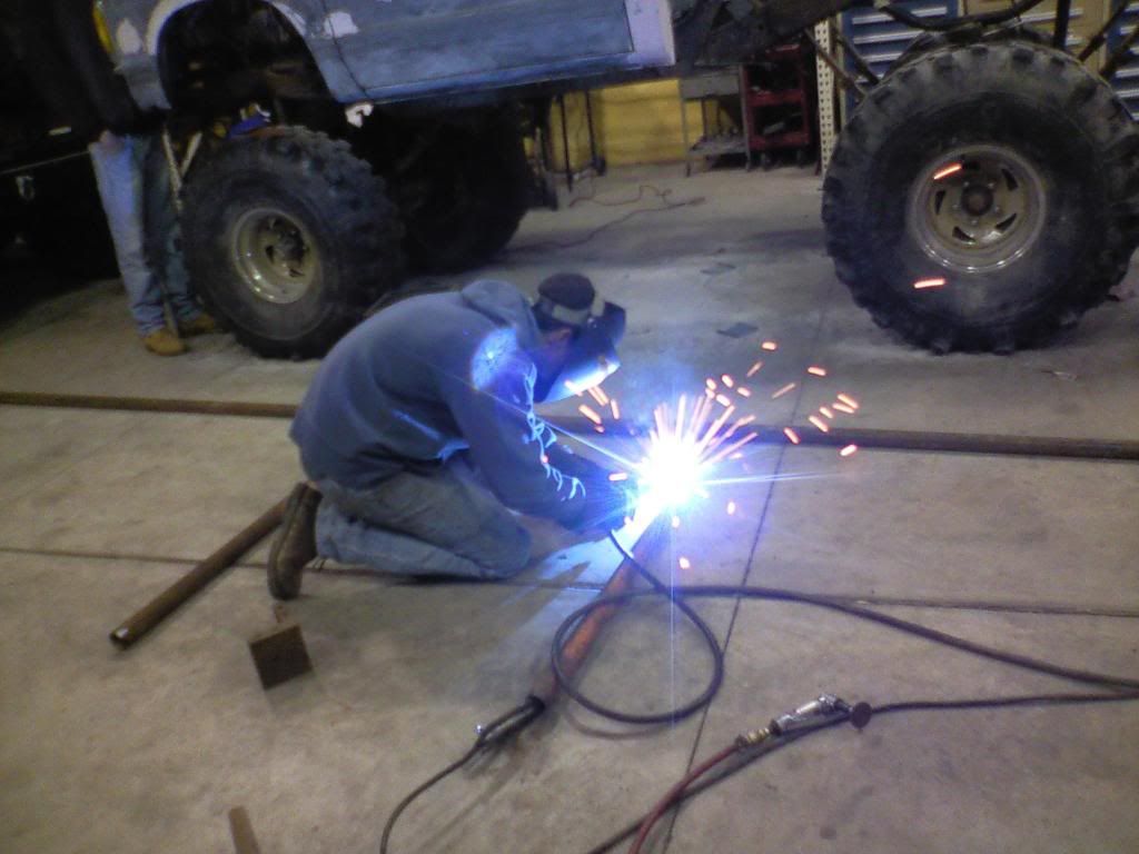

we spent all night cuting out the bed and buildin a role cage
then i spent the next day cutting the bar off cause it was ugly lol

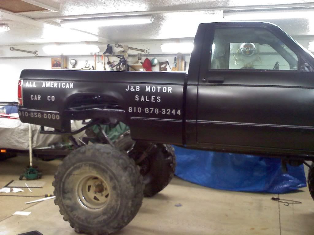

here she is getting ready to be painted.
and fresh outa paint
thats tractor paint lol 35 bucks a gallon lmao

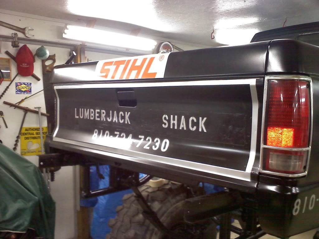

here are some of our sponsors that i started to paint on
oh and check out these leafs lol

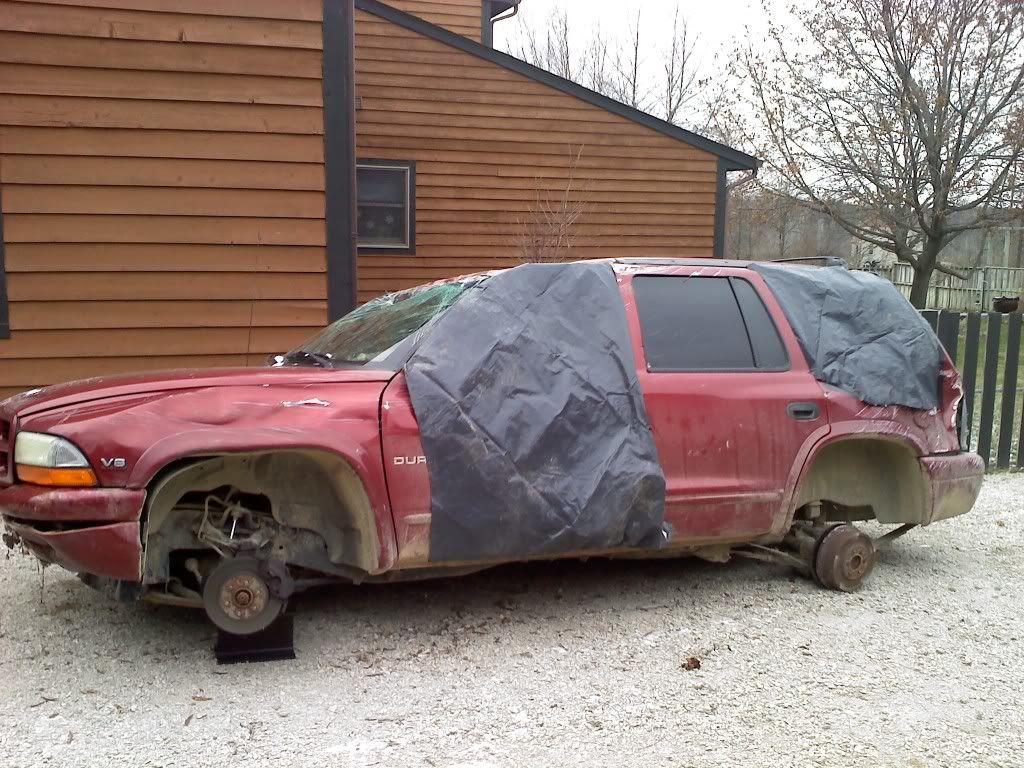

oh and btw i got the drivetrain all figured out. my buddy flipped his durango the other day he is fine but his dad said if i paid the tow truck fee and the impound fee then i could have it so.....340 bucks and i got this i am gonna use the engine trans and t case...but now i need a new front axle cause the d44 i have is a passanger drop and the durango tcase is driver side so if any one has a axle they wanna sell that would be awsome. so thats pretty much where she stands as of now
ohhh just trade the tcase for a 241 drivers drop...lol
