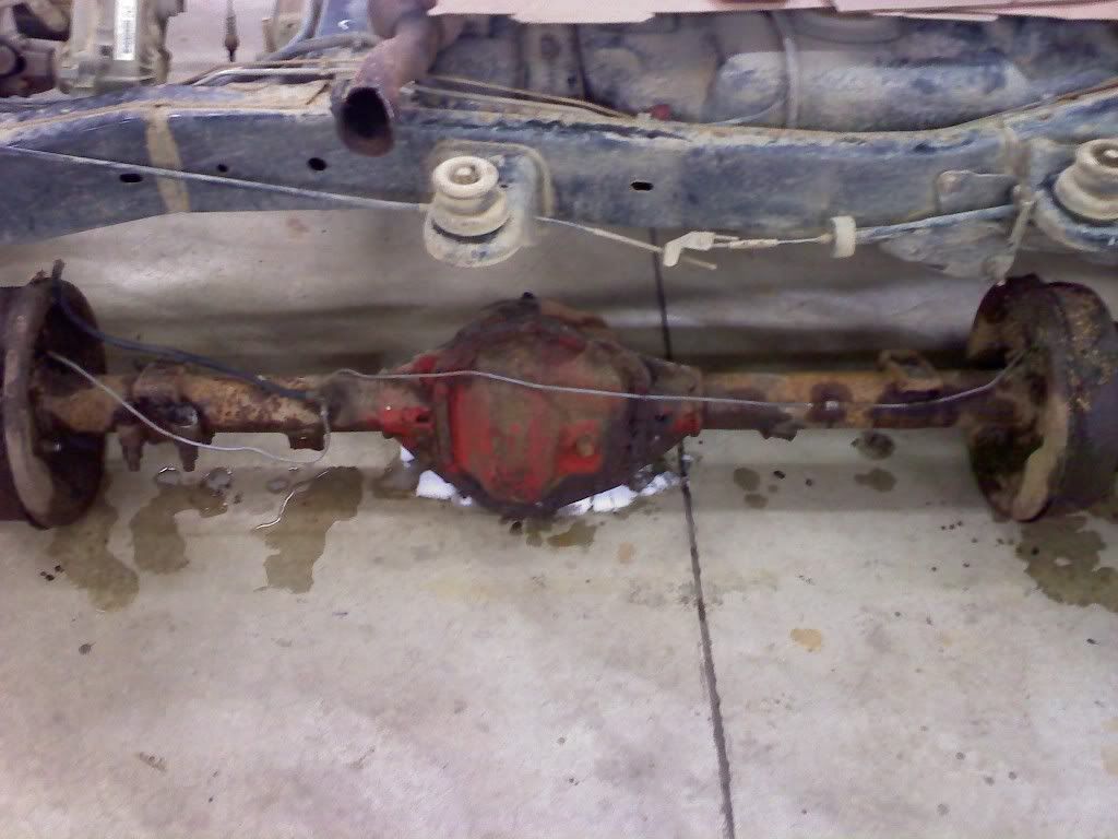

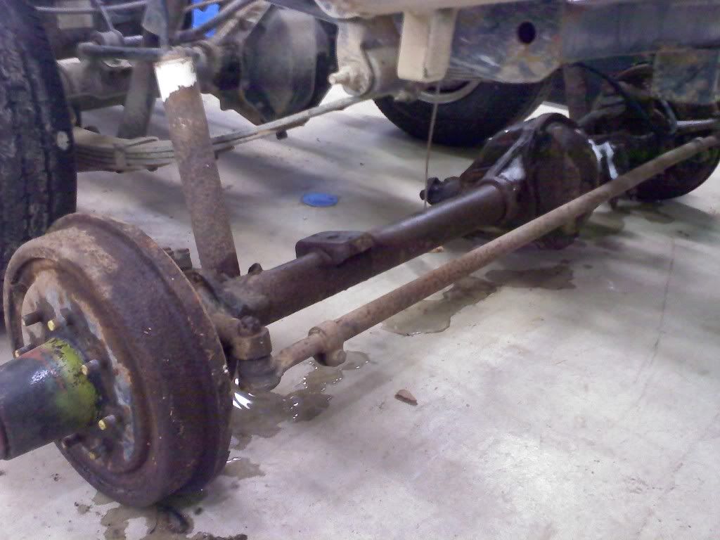

here's a small update. we got our new axles thanks to terspr250 hooking us up with a great deal, thanks again. we have a dana60 rear now and a dana44 for the front.

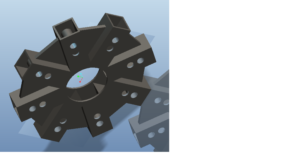

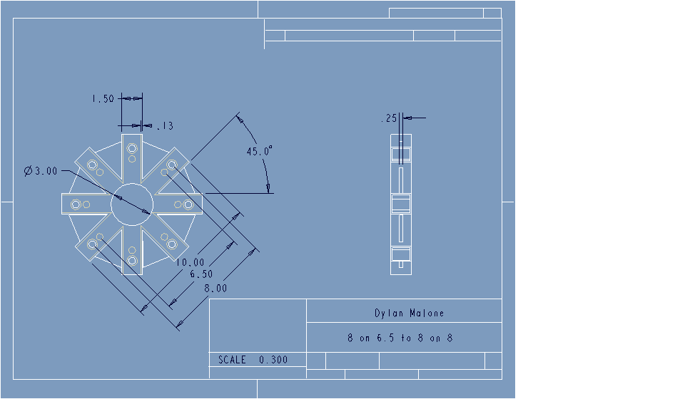

ok so the tires that i want are 8 on 8 and our axles are 8 on 6.5. so i was thinking about making some adapters this is what ive come up with let me know what you all think.
dfm_13
yea i guessed on the center hole till i get a measurement. and i think about welding a nut on the inside of the tube for the 6.5 and then hitting the studs outta the drum and put a bolt in from the inside of the drum to the welded nut on my adapter. if that makes sense? lol then for the 8" there is a little sleve in the tubing so it wont get crushed then just run a bolt all the way through.
dfm_13
oh and its hard to see in the pic but the 6.5" don't go all the way through that why i want to weld a nut in.
dfm_13
i will remove the studs on the axles. put bolts in instead in tightened them from behind the adapter and drum will be one piece and come off together. in stead of just attaching the addapter you need to first remove the drum then bolt them together. i know its hard to explain over a message.
dfm_13
going with tractor tires so that wont happen lol i'm afraid that if i drill a hole all the way through for the studs that the 2 holes will be to close together and will be weak.
#49
have you ever seen a wheel spacer? the ones i have seen are machined so the old studs are in the middle, not above like your drawing, you might have to go that route, ya know? you design looks more complicated than needed ( i mean this nicely) start with a solid chunk that you can bolt on with the old lugs and studs, and clock it so the new studs are between the others. that thing you drew up looks very hard to make with a lot of parts that need lined up perfectly and a lot of welds that could fail. like they say k.i.s.s.....keep it simple smarty!
forget the wheel adapters, weld new centers in your rims, it'll be stronger than an adapter and be way easier to do,
