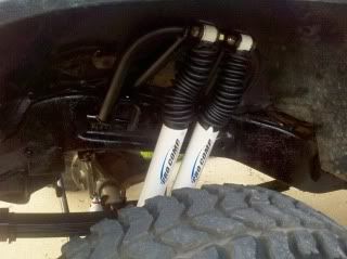

Yeah I want the procomp 9000. I didn't get them ordered yet because summit doesn't have the length I need. I might have to resort to offroaddirect seeing he does, shipping time just seems to take forever.
The shocks will stretch out at 32 inches so I need at least taller than that, im thinking 35 so I can always lift it more for 38s

i would NOT reccomend puting the 9000s on the front.... with that duall shock tower it will be a STTIIIFFFFFFF ride.... i run dual hydralic shocks and it can be stiff at times.... allthough i have the next step up with nitros in the back and just the single ones are stiff too. but it does ride real nice in the back when its got an extra 500lbs loaded down in it

Well I didn't wait for feedback lol. Summit had some and shipped them yesterday, and they will be here today. I guess a stiff ride it will be.  My front is super soft right now. The 52's have a lot of give vs. The 47's.

well stiff aint a bad thing either i guess... itl help with body roll with those soft springs!

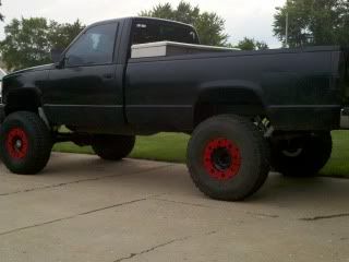

lookin good! i like the red beadlocks!  applaudd

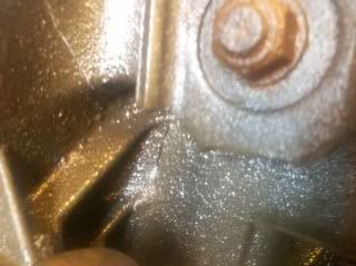

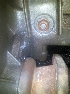

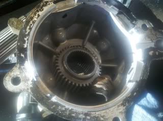

I did crack my t case at the end of the day. Right above the front output. This one didn't have the brace that runs he the front of the truck and im sure that's why it cracked.

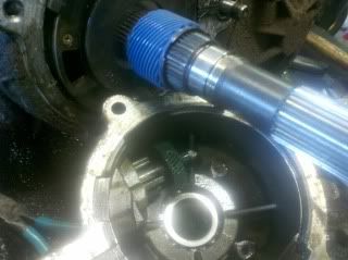

I had another 241 with mechanical speedo.  I took them apart last night and put the pickup sensor and gear in the 89 case.
Crack.
Out with the old mechanical
In with electric
The trans shifts fine and it all works good. I will get the support put on this one so hopefully it doesn't happen again.
