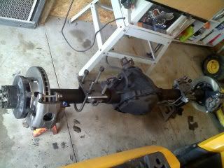

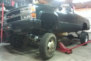

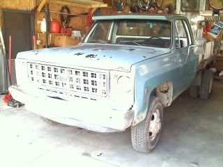

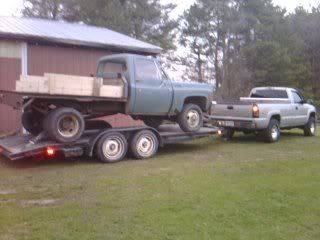

1979 Chevy D60

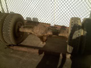

1979 Cab and Chassis 14bolt converted to SRW
pass drop 241
Off Road Design shackle flip
52" up front
37" hummer tires on stock h1's not recentered!

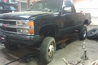

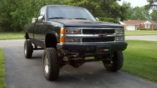

This is where I am for now, won't get much done over the holiday weekend.
The only parts I need now are my 52" springs, which if anyone has any stocks or lifts lemme know!!!!... and brake line extentions.

sweet build! do 15" wheels fit with that rear disk conversion?
jaredw
ahh not too sure.  i would imagine.  I have my duramax rims on there now which are just 16's and they are fine. they are 1979 1 ton front rotors

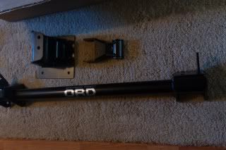

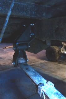

  It comes with dual shock hoops, all the hardware and spring plates front and rear hangers with shackles.  bolt it up and move on.

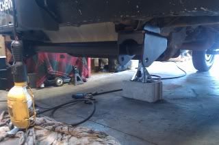

Yeah I don't like having stuff tore apart for that long.  I'm heading to Beatie Spring today to hopefully have all new u bolts made, I want to have both axles bolted down and my steering on if it shows up today.

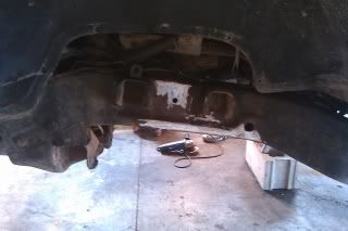

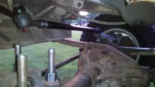

Anyone know where to put the angle finder on this D 60 to check my caster?  I dunno where its supposed to be.  Do you guys think I will need shims?
==dew

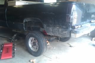

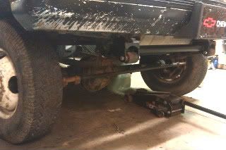

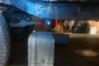

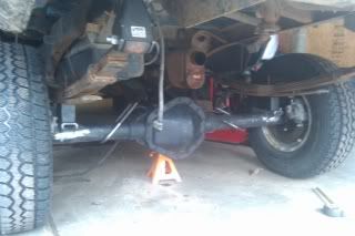

measuring what i need for brake lines length.  took a quick pic of the 52"s flexed out.
==dew
Kyle
thats pretty good flex for leafs. are they 4 inch lift leafs?
jaredw
stock 52 rears from a k5
==dew

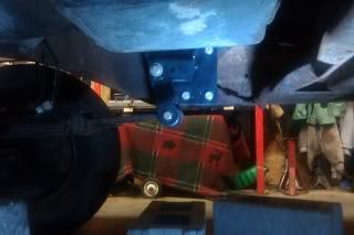

jaredw
==dew
Kyle
jaredw
ya, i like how u made all ur own p00, just not an option for me right now and I really just wanted to get it done.
