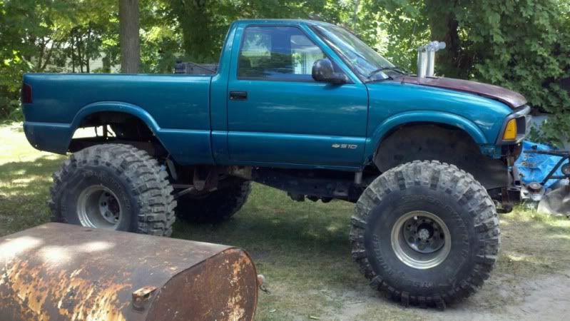

this is my buddy cades (blackout) new mud truck he just put together. will get more pics and some vids this weekend of its first time out.

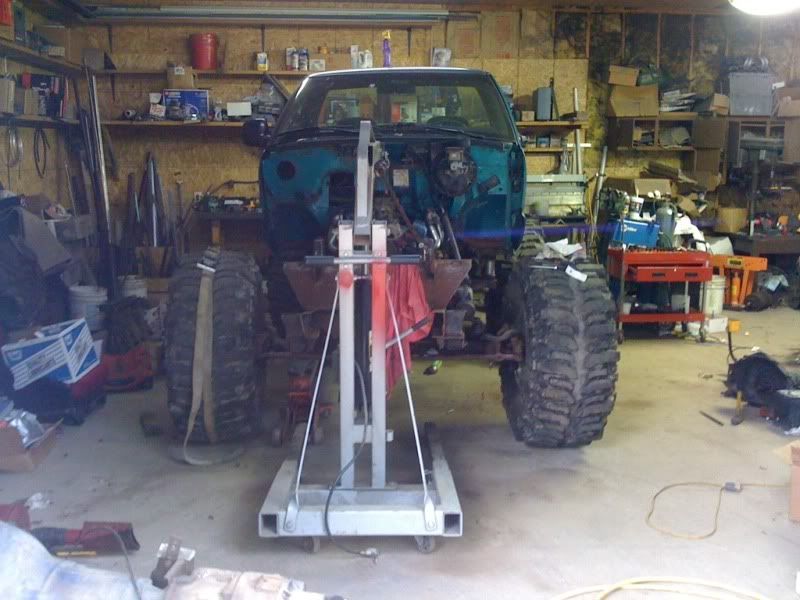

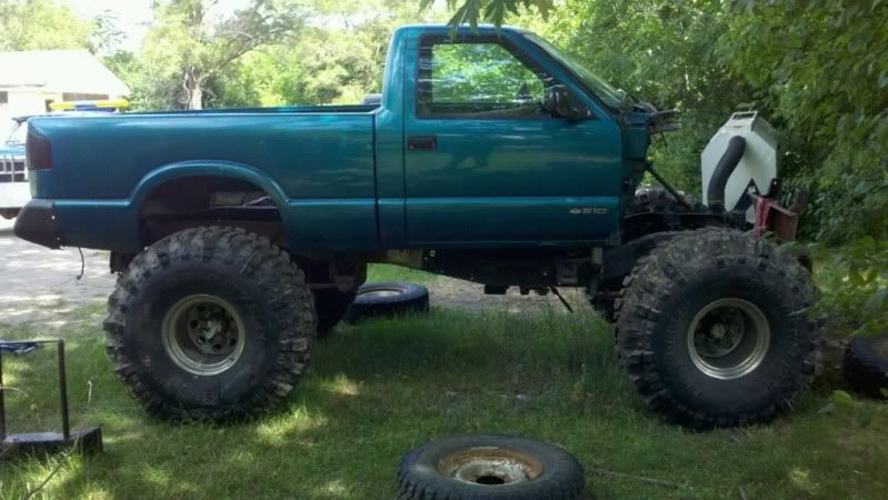

Well I guess I'll chime in now. I'll get some more pics of finer details soon. The truck started as a crude cobbled body, frame and axles. In the last three weeks got put together.

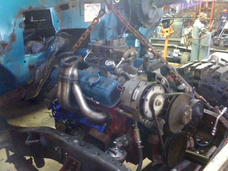

Engine
010 4 bolt block .030 over
scat 9000 3.75 crank
speed pro hyper flattops
RHS 200 cc cast heads, 2.02 valve, 64cc chambers
lunati 268/276 hydraulic flat tapet
stainless 1.52 roller rockers
vic jr intake
750 dp holley running av 100 gas
Block hugger 1 5/8 headers upside down with 3'' pipes through the hood
TH 350
3500 stall
208 case
FF 14 bolt rear
gov lock
4.10
disk brakes
10 bolt front (for now)
no brakes
4.10
44 boggers
14 in wide 16.5's
battery, fuel cell and radiator in back
big block late 80's chevy radiator with duel fans off a ford winstar
fIrst time out went awsome got no bad suprises just problems I planned on. Made about 9 passes got stuck a couple times. Decided to bomb a cat tail swamp. The alt belt came off I'm guessing because of the sudden rpm increase due to breaking both front axle joints and shafts. lol. still made the hole in 2wd.
In 2wd drive it holds about 5500 rpm in 2nd gear and 4wd I never saw the tach below 6000 and usually between 6500 and 6800 in first. This was a 90 deg day and some of the thickest clay ive ever been in so I think i'm gonna stick to the 4.10's. I seem to find more hp 60's so i'm thinking about goin drivers drop 241 and hp 60. I'll get a touch better ratio with the 241 and they are easier to find for me.
That's the plan for now anyway.
