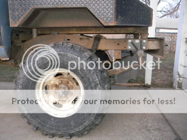

Going to head up to John R spring here in a min, get new ubolts and shims..  Goin to get 4 and 6 degree just to see what gets it closer to where it should be...  Paul was correct, pinion/diff needs to be paralell with trans/tcase ( thanks tom woods tech site )..  maybe if we can get Robs truck done today ill get mine straighten out tomarrow...  Seeking a decent used Drive shaft, apx 28-29 in long collasped..

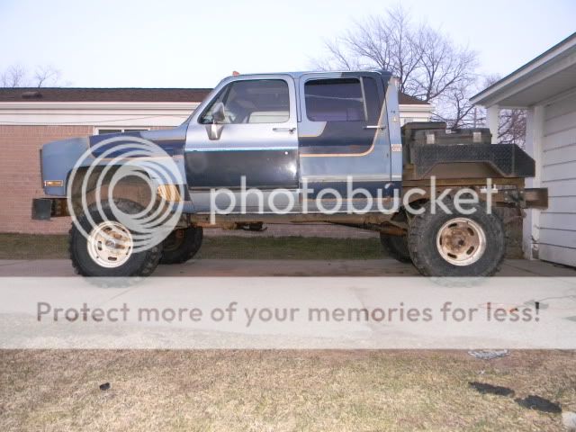

FLip Kit In!! Got about 2.5 inches higher outta the suspension updating...
Found out today i need 5.8 deg of shim to fix pinion angle, Thanks Mumblys Offroad for taking the guess work out of it...  Ive got the shims so thats tomarrows project after..

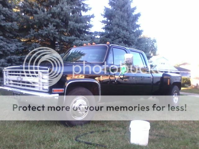

Ive made a new addition to the family..  1986 chevy 1 ton
2 wheel drive, 4 speed, big block truck...
Soon The Mutt will be a trailer queen!
