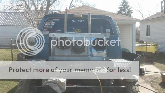

Had the itch!!  got a holley 750 duel feed put on, holy smokes the differance!!  gonna make for a fun ride..   I have been building an encloser to relocate the radiator to the bed, its just about done...  goin to have a small shroud build and put a 1100 cfm fan on for trans coolers...  Ordered a 10 gallon fuel cell so i can remove the huge 28 gallon and put the radiator box in it spot...  next will be coolant lines, trans line and oil cooler lines..

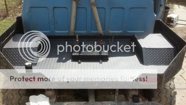

I should have my block back from the machine shop very soon..  had to have crank turned, all new bearings, oil pump, cam, lifters and push rods..  basicly gotta fresh motor again this year..  Had some free time on my hands and made a couple mods, moved the radiator as noted in other posts.. Started pluming it in tonight, should work well..
Also sprayed the bed with bedliner and sunk a 10 gallon fuel cell in it.
More to come as it unfolds!

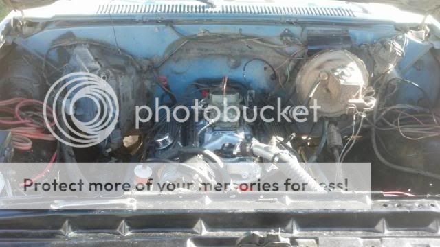

I did finally get the motor back and all togather,
completely different beast..  had some bugs to work out but that was expected..
Ran out at carsonville a couple weeks ago, ended up braking the inside shackle on the front passenger side spring...  So I upgraded to some nice 1/2 thick and a little taller then stock shackels... I don't think ill brake those but brought another issue to my attention, the volicity stack is hitting the cross member under full suspension unload so making a new one is my project this weekend is nothing else come up..
