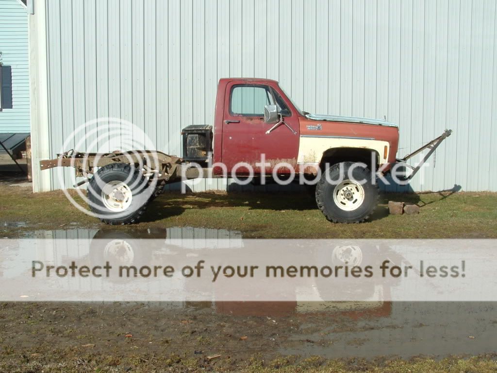

I really wish i woud of done this a long time ago, but as they say better late then never...  This has been my on going project for just over 3 years now...  It started life as a 78 Chevy suburban half ton that had been previously wheel had in the Rocky Mountains, not a straight body panel on it but solid frame.. I had a buddy make a deal with me to scrap the body ( cuz he didnt like it ) and he would hook me up with a cab ( 2 door ) and a set of 3/4 ton axles.. Seemed to be a good deal..
This is what we ended up with..  Over the course of the next couple months it got 4in springs in the from and a custum junkyard pack for the rear...

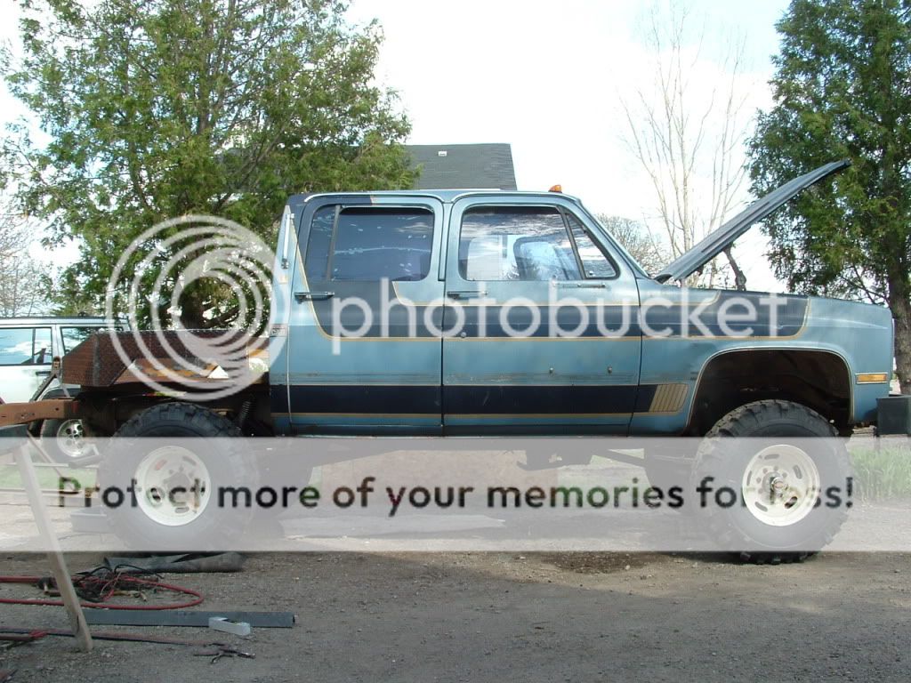

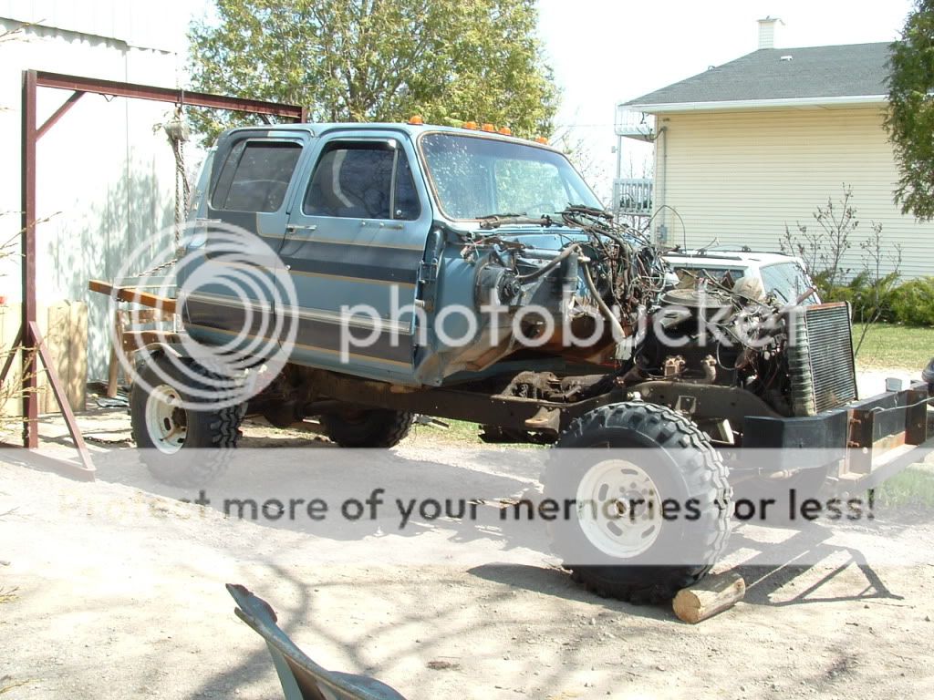

After a couple times out like this, with 4 people packed in things got tight leaving the idea of a 4 door cab behind...  A little digging and searching resaulted in finding an 84 chevy 1 ton factory 4 door truck fresh from texas that was bought for the motor..  So i purchesed the cab from it..
after a little modifaction it sat nicly on the burban frame..
Next was the void on the back, needed a bed of some sort so i tought about it and came up with a drawing of what i wanted.. Had a freind of a friend hook us up with enough to build it outa old diamond plating.. come out just as i wanted.. thanks big frank..

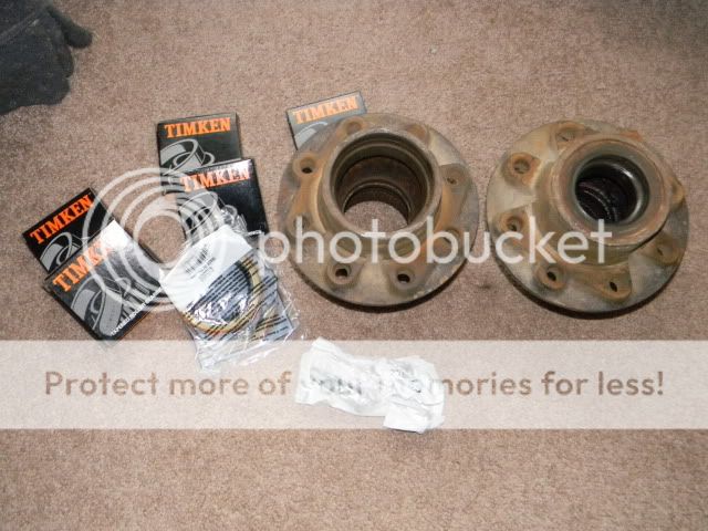

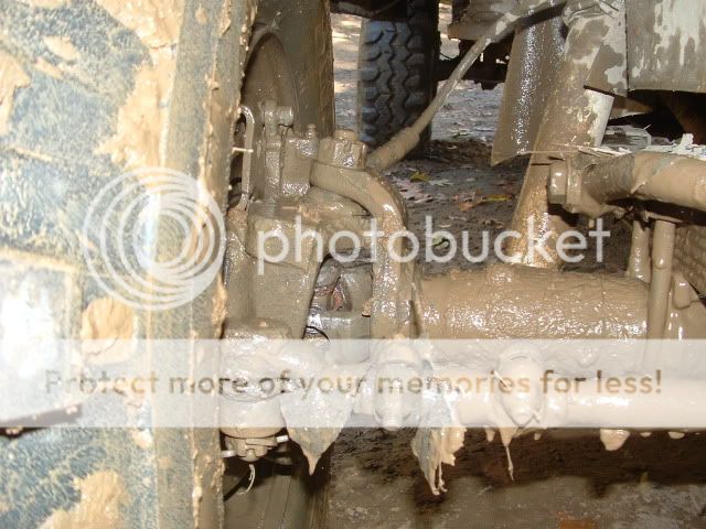

As Big Frank said, at this point in the build i had just thought about mud bogs.. Opened up a hole new world of fun.. This is also about the time i had my frist mounds.. which lead me to find my weak link, the dana 44 front axle...

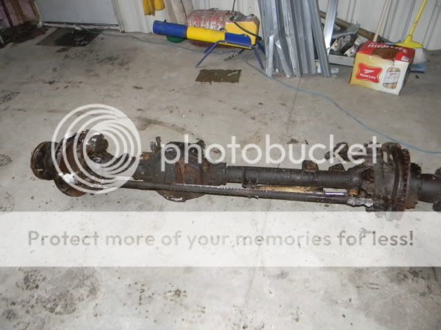

After several broken Ujoints in the axle shafts, 1 set of spider gears, it was time to upgrade to a Dana 60 front...
Took a duelly and coverted it to single wheel..

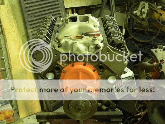

Ive made a bit of progress as of late... Finally got my SBC pretty much all togather, just needs a little paint and a couple more things..

Got to see my trans all ripped apart, thats gonna require a bit of parts to make it hold up but i feel confadent ive got the right guy on it...  Headers are install and piped to muffers, sounds pretty good but not very loud at all.. that should bee the law off my ass..  Hopfully take her out to Mounds tomarrow, make sure the drive shaft clears the headders under full flex...  More to came as she comes togather..

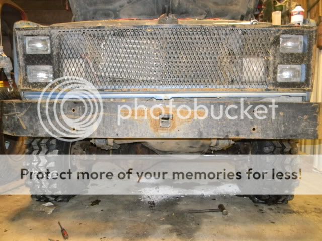

Got looken at the headder/exhaust job, for the drivers side headder right tight up against the oil filter... That cant be good.. Going to try the smaller filter to see if that gives me room, if not im goin to have to remove the oil cooling ( i wanna call it a sending uint ) thing thats inbetween the oil filter and block..  Almost looking like im not goin to be able to run the GM oil cooling package i found...

i was wonderin how they would fit in there   lookin at the oil cooler kit looks like a short filter and the adapter is bout as tall as the long filter by itself   pa said he thought there was another version that mounts the filter up under the hood on the inner fender or where ever it mounts ??? ??? ??? ??? ??? ??? ???

the remote oil filter might almost be a good idea, so its not baken right next the headder..
A small filter fit with about 1/4 in of clearance..
