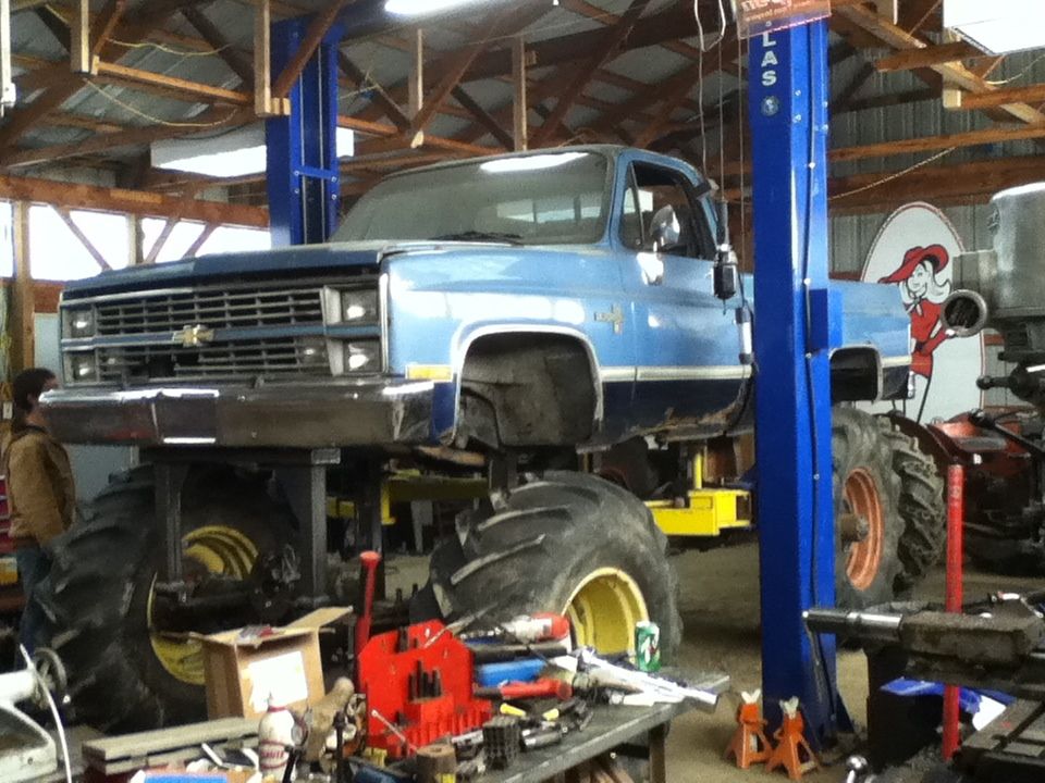

i like r u keeping it the same color
Go big or go home
84silverado
for now yes i plan on keeping it the same color. i prolly wont think about paint till im out of the navy and go through and do body work
78man
Jakes Brush Removal
mud gremlin
cool i like that color blue
Go big or go home
84silverado
Color shows even better when its been hand washed  ;D

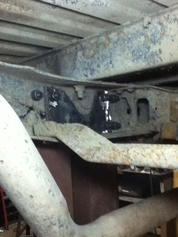

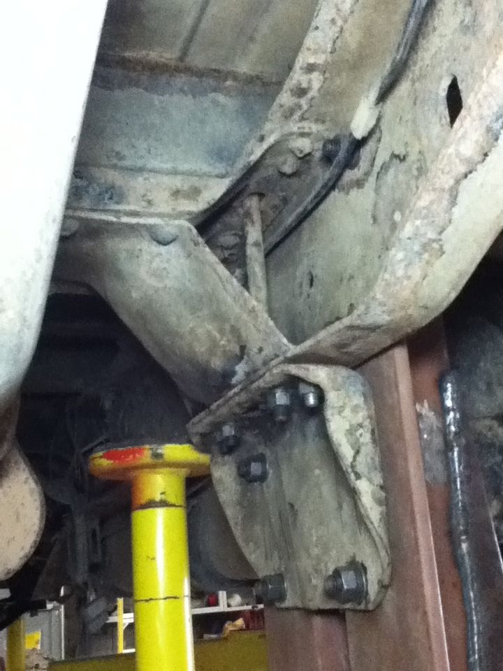

Are you goin to brace those hangers so they dont fold over when you hit the mud? Otherwise lookin good nice start.
84silverado
#30

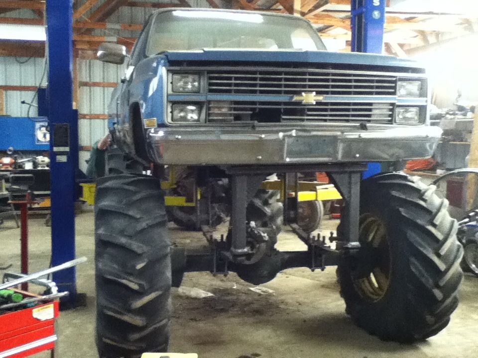

The rear hangers have a plate on the inside of the frame so that its bolted to the frame and the plate is 8"long and 3.5" tall so its just as tall as the inside of the frame. The front hangers i used the stock braces from the backside of the stock hangers and i plated the inside of the frame. Well, plan on it anyways, ran outta plate. And i dont think that they will ever move but if they do then ill run something between them so they dont move around. Ill put up pictures later when i get home
84silverado
heres what ive done so far to brace up the hangers in the rear end. if anything moves anytime wheelin ill brace it more but until then i think ill be alrite.

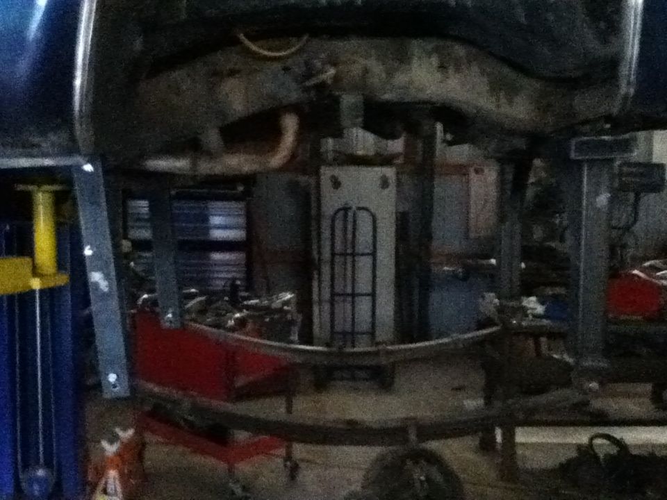

Yesterday i went and got some pretty awesome 18.4 rice and canes from blackout, cant wait to see what they can do  ;D i also got the front end suspension close to being all finished up just gotta tighten up some bolts and put the axle in place
BAD APPLE
Holy shackles batman
no rest for the wicked
84silverado
well i got my front axle pretty much buttoned up...my back started to give on me so i called it a night. about another hour in the garage tommorow mornin' and itll be in  ++peace

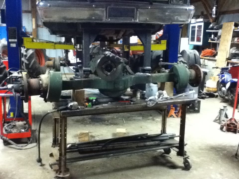

84silverado
Yes! I got the front all buttoned up and in and mounted now on to tearin the rear apart to lock it up and put the pinion break on. But its finally standin on its own!!!! ++peace ;D
comanchee bogger
  applaudd  Lookin good!
