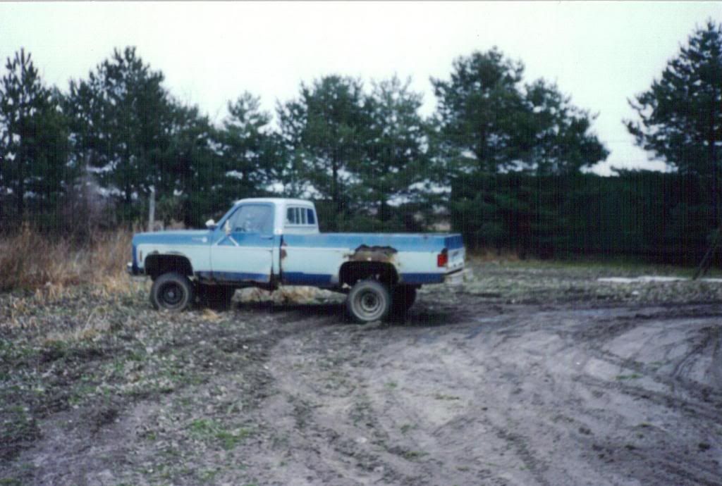

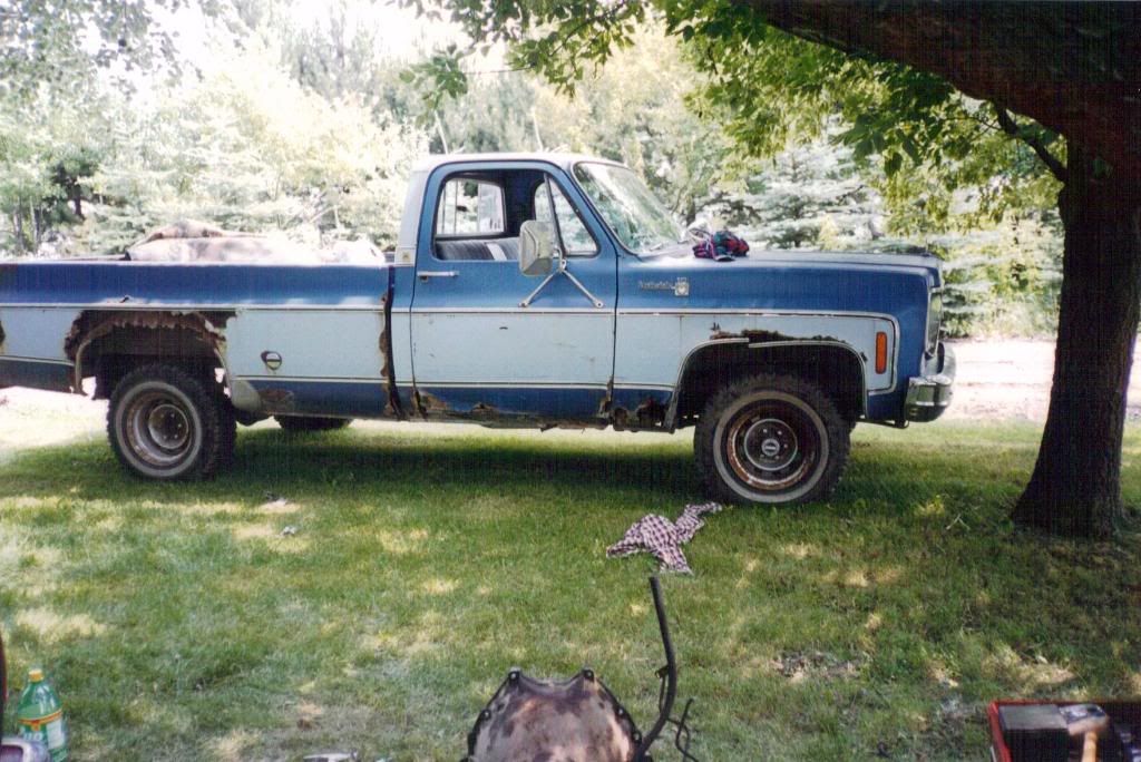

1978 Chevy Stock
1978 Chevy 4" lift

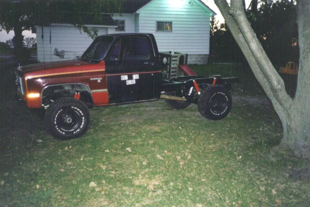

 1981 Chevy From Arizona
New 396bb

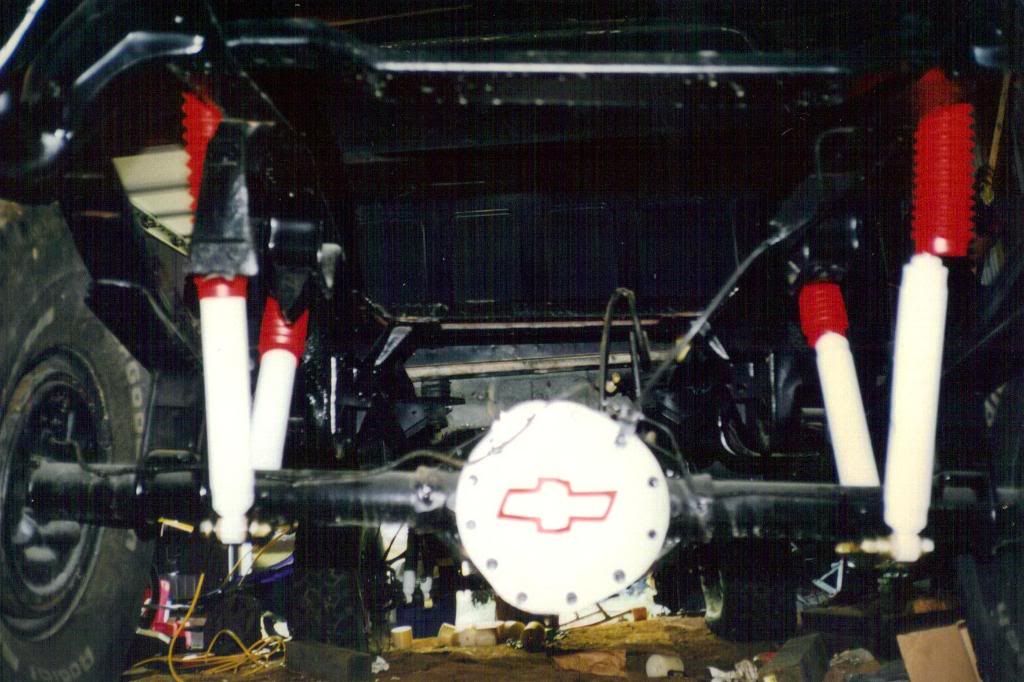

Dual Rear Shocks
2-1/2Dual Flomasters
1987 Oklahoma Clip
396bb all in
Full truck

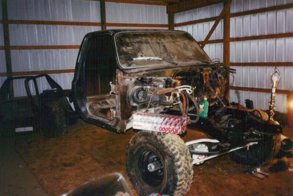

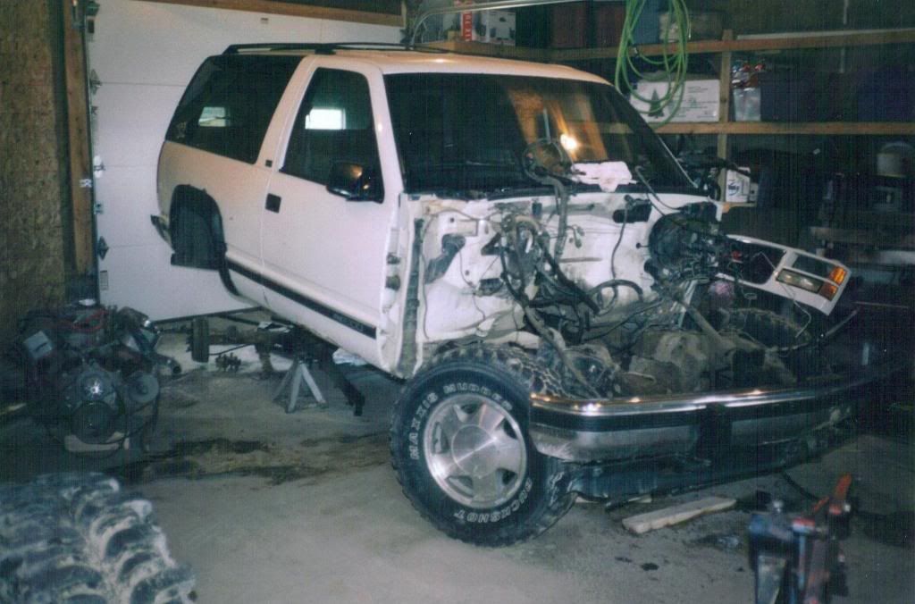

1994 Yukon

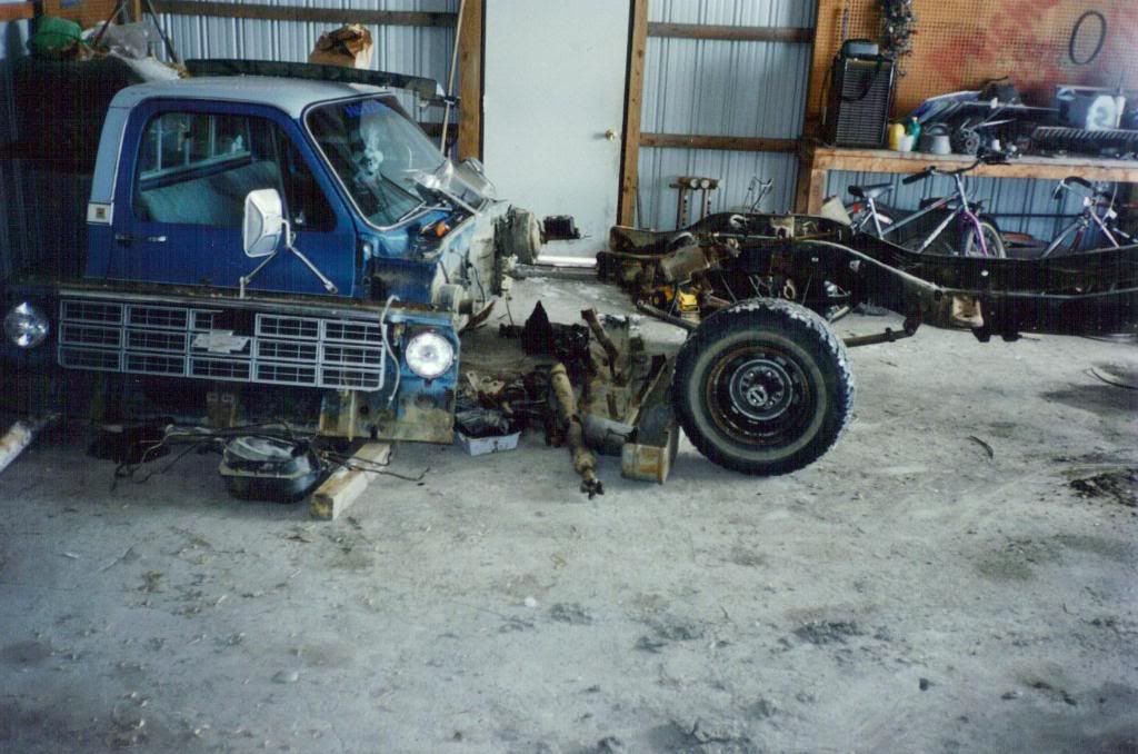

SAS Start Strip
Not much left Of Not For Hire

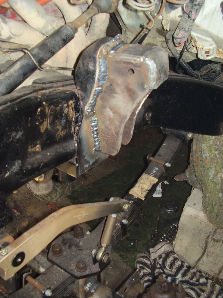

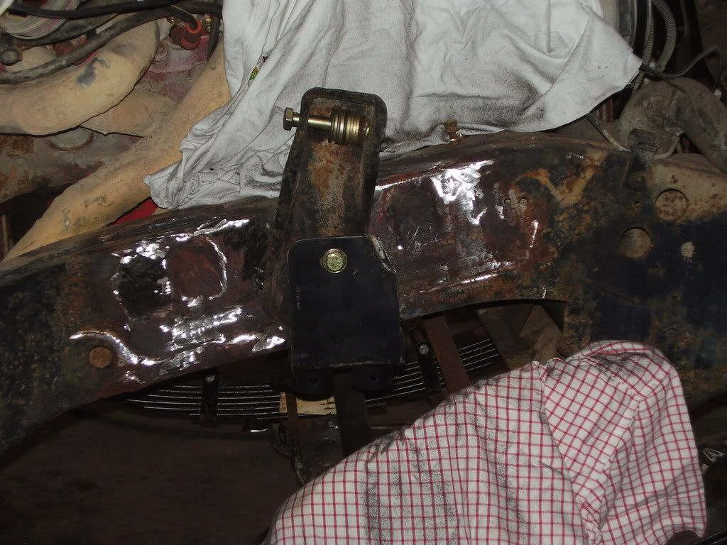

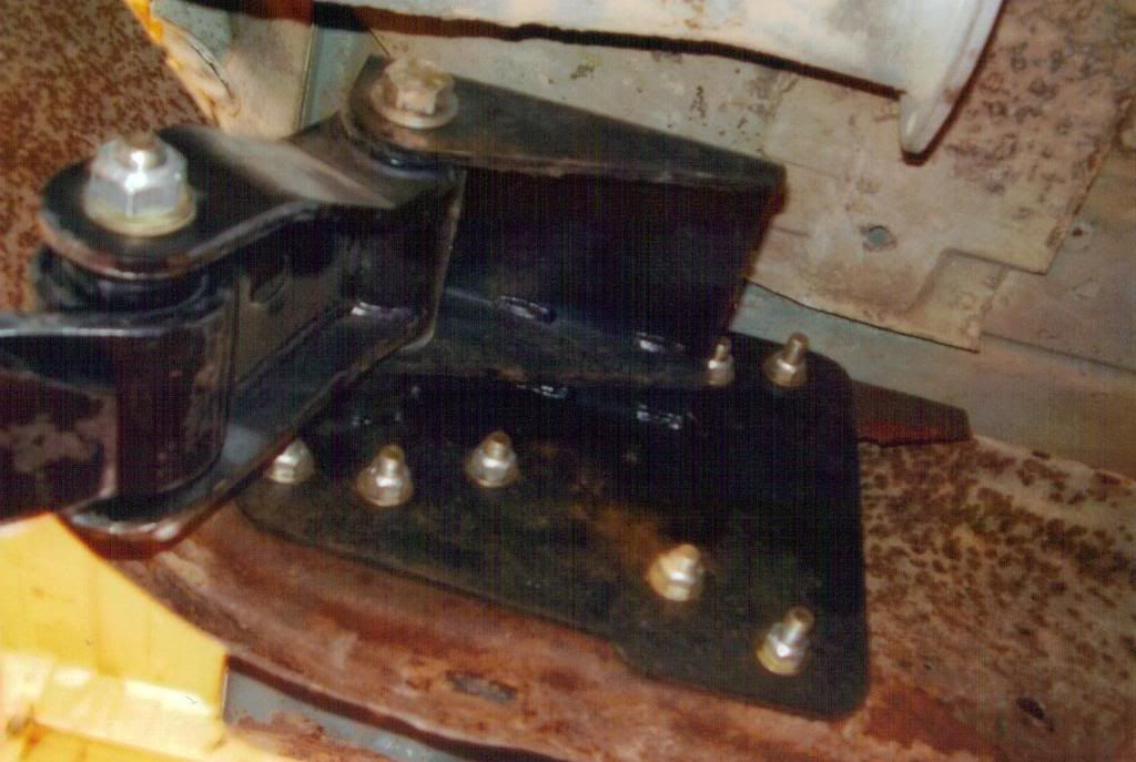

Front Spring Bracket

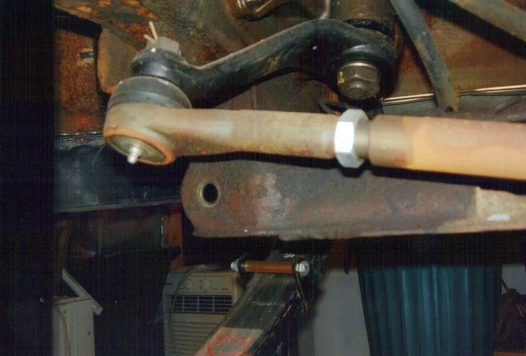

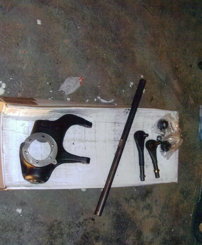

10 Bolt High steer Nuckle
High Steer Nuckle
Drop pitment arm

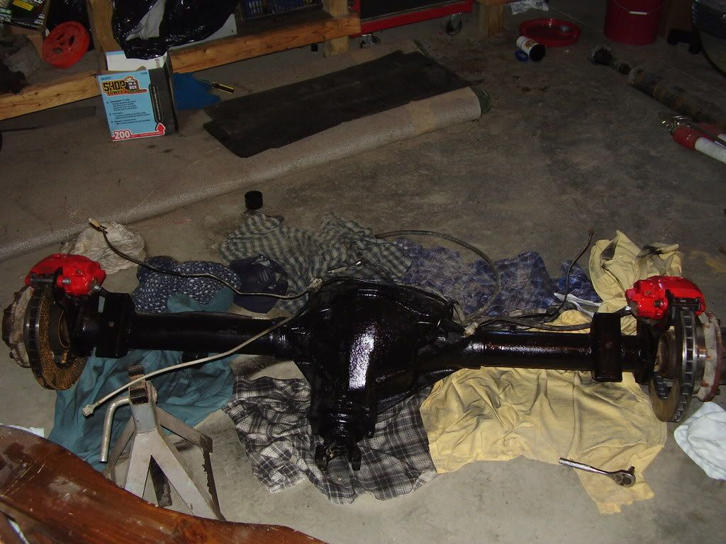

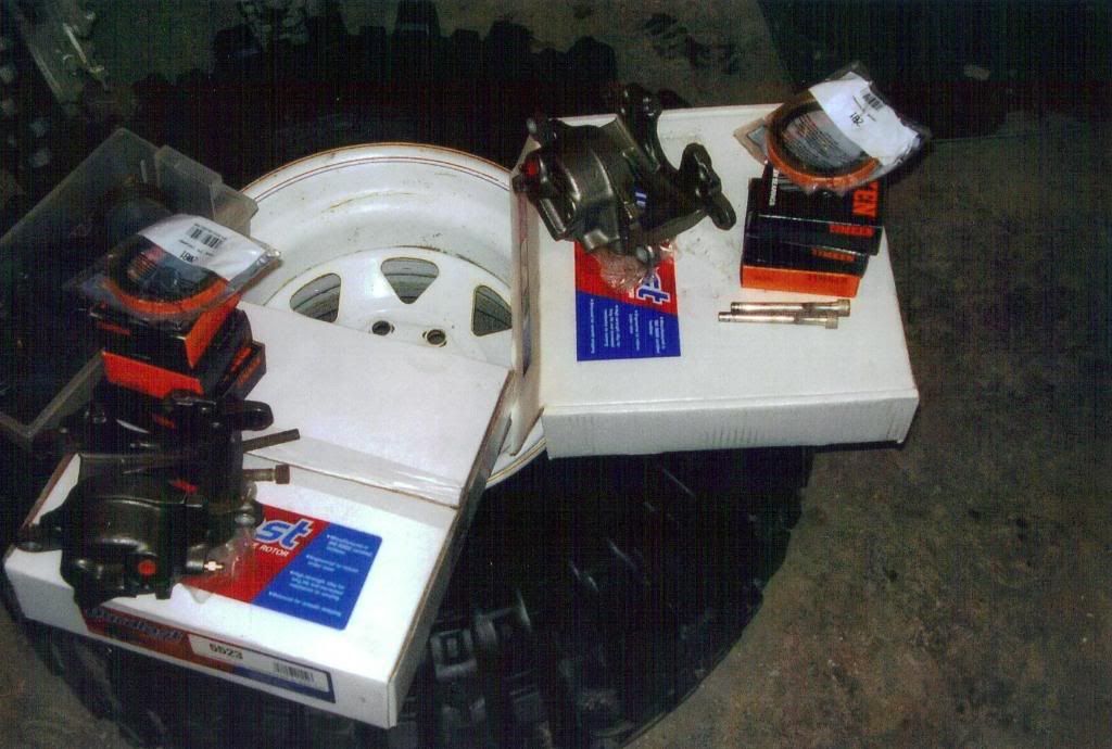

Disc Brake Convertion
14 Bolt Disc Set-Up

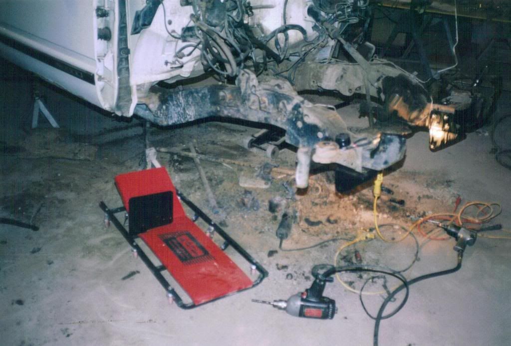

Remove 10 Bolt
Dodge Dana 60
Pulled5:13's For 4:56~!#s
New King Pins

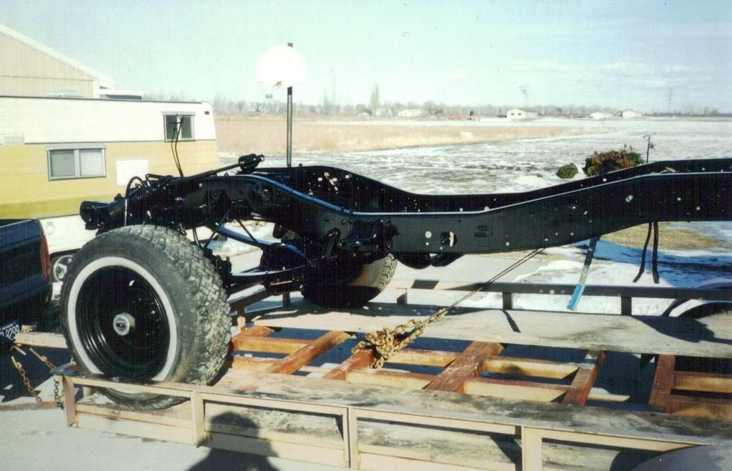

Cleaned Frame

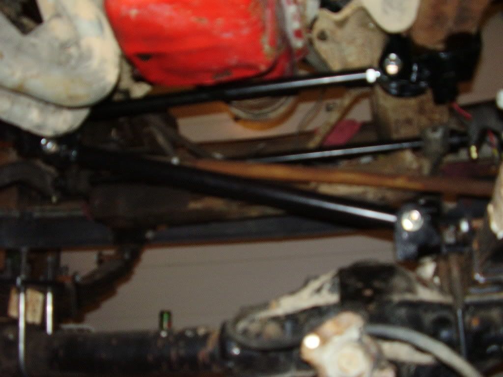

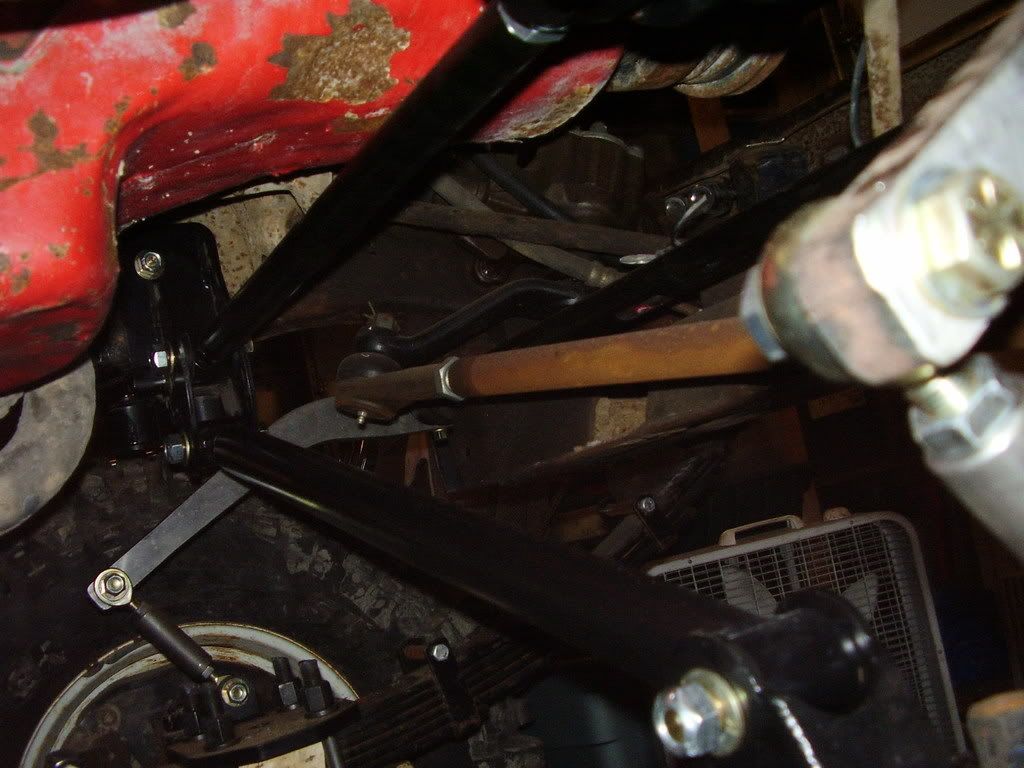

Trac-Bar
Sway Bar

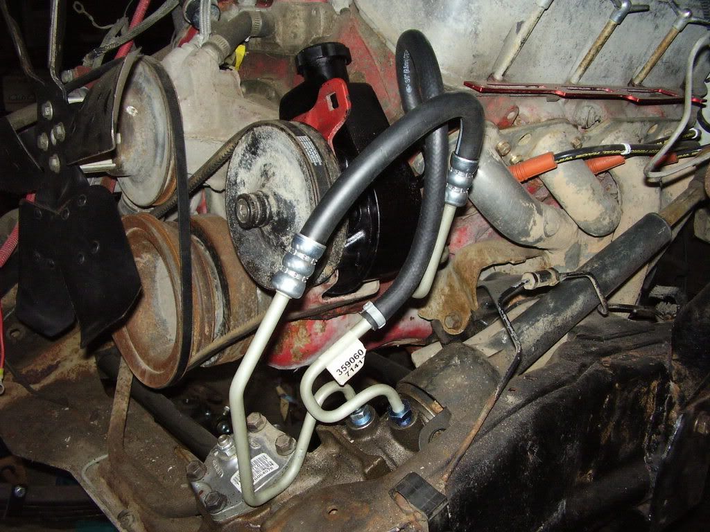

New Power Steering Pump

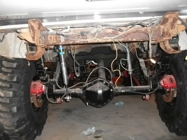

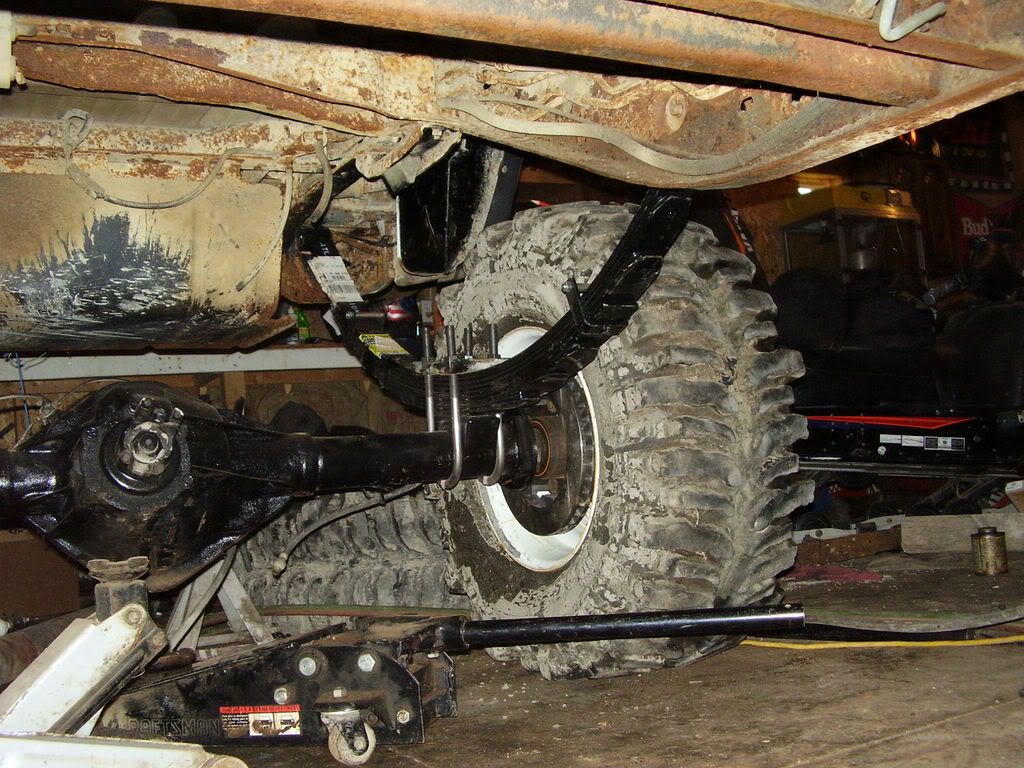

New Rear Springs Going In
14 Bolt Cleaned Up
Rear Spings In
Trac-Bars Mounted

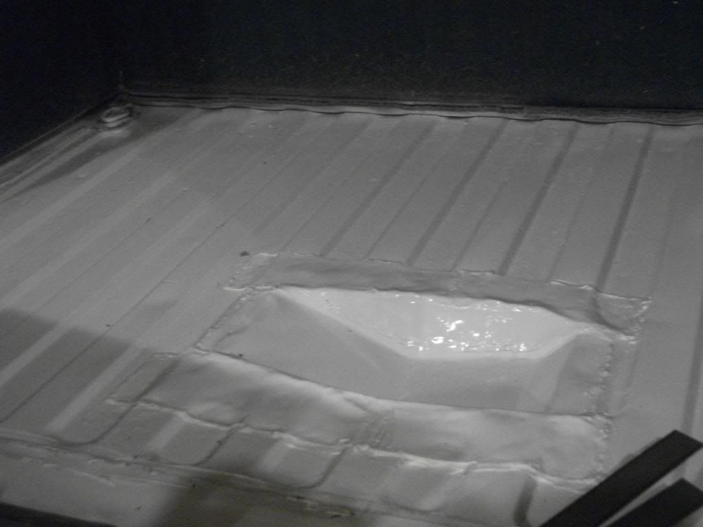

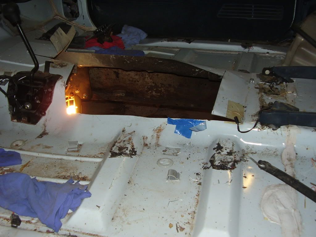

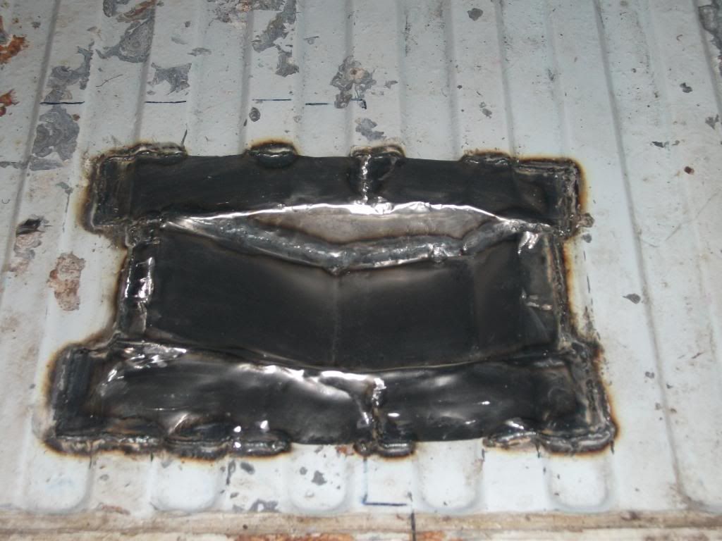

Start Removable Floor Pan
44 BOGGERS YES!!!!
Remove Gas Tank (before an after)

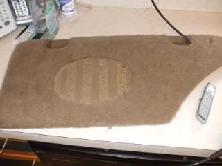

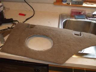

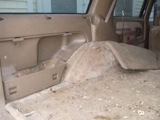

Family Night Remove Carpet

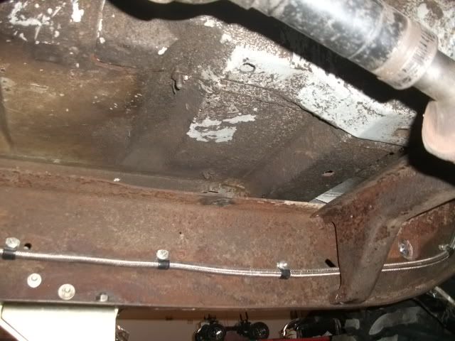

Strap Fuel Line To Front

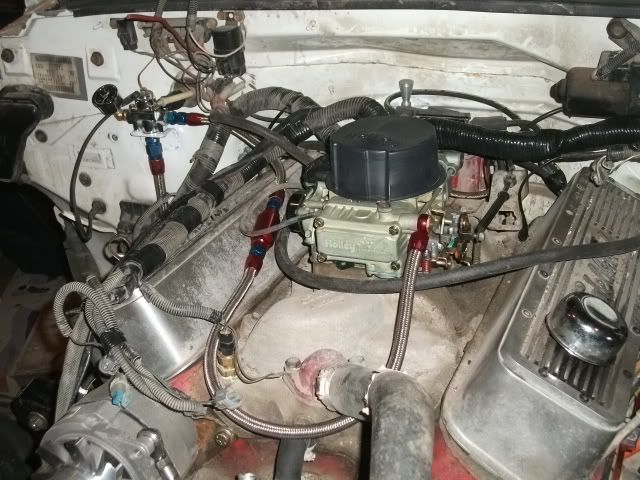

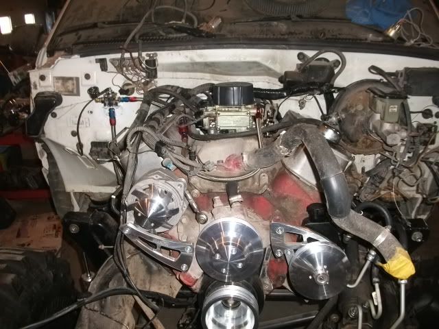

New 770 Truck Avenger Carb.
SerpantinePully Set-Up

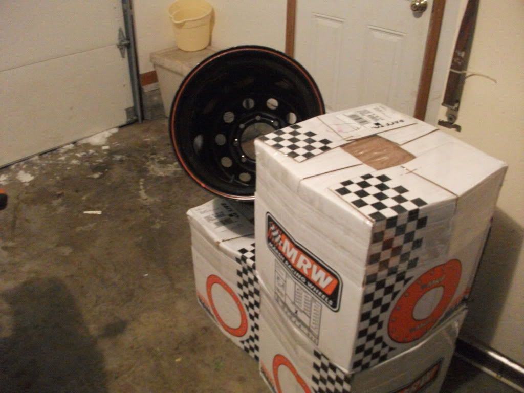

MRW Rims 16"Wide

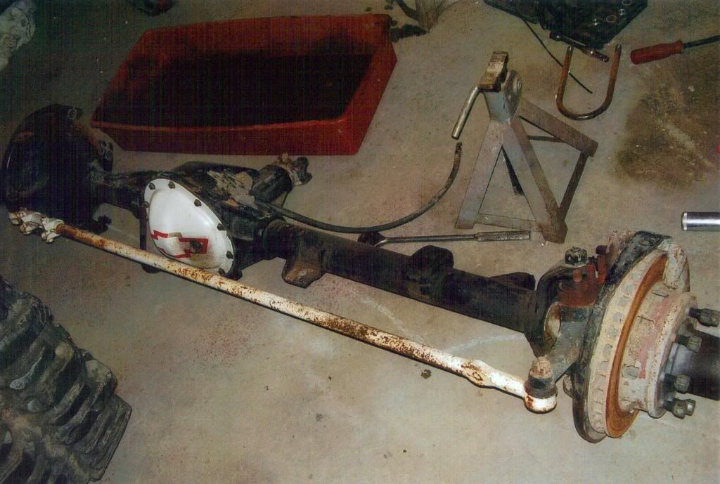

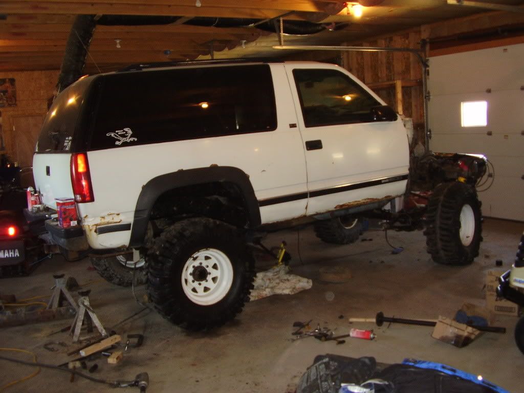

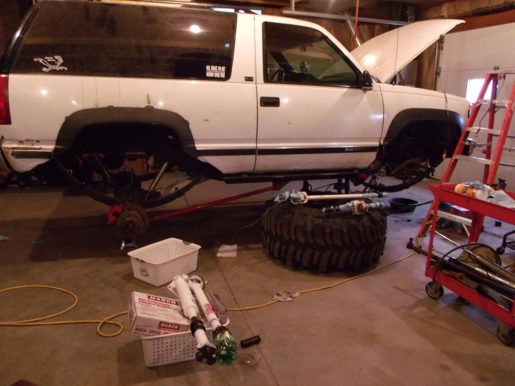

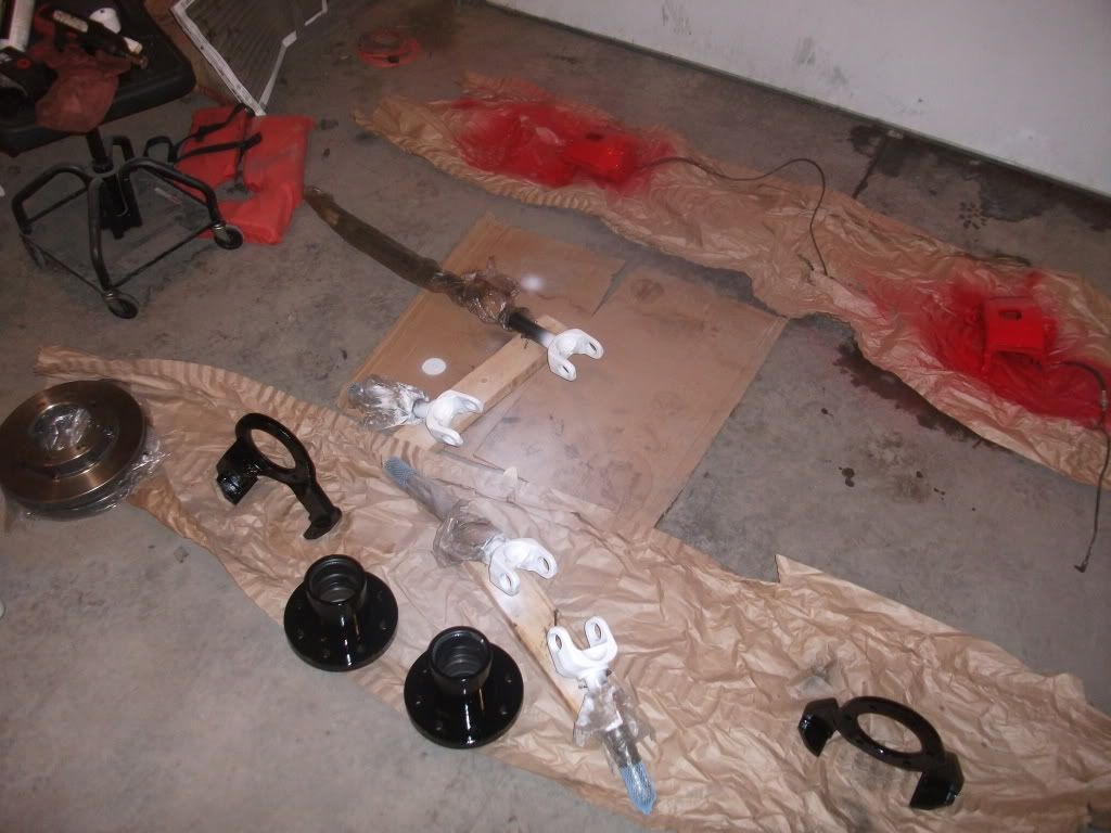

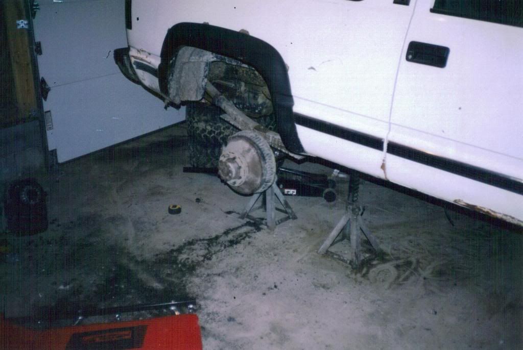

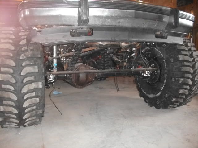

New Yukon Axles 35 spline  with super joint u-joints---- converting from dodge outer hus to Chevy Hubs

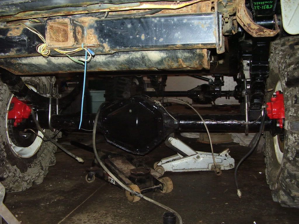

60 Going Back Together
60 Looking Tuff

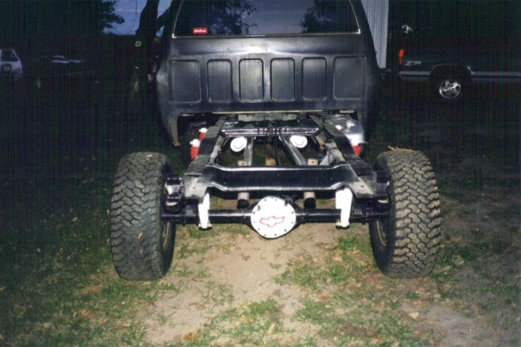

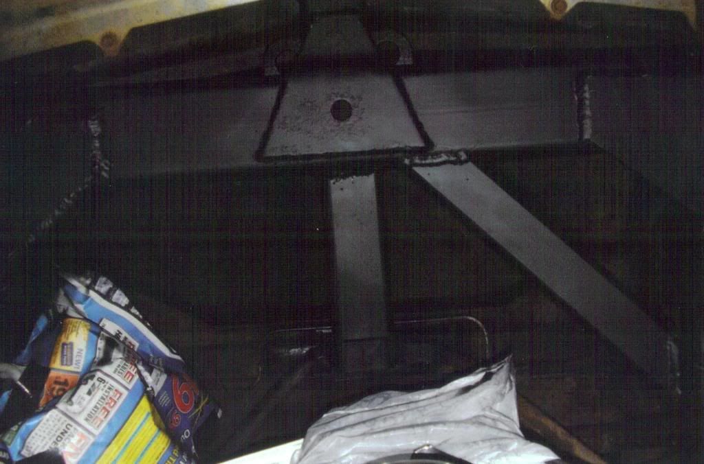

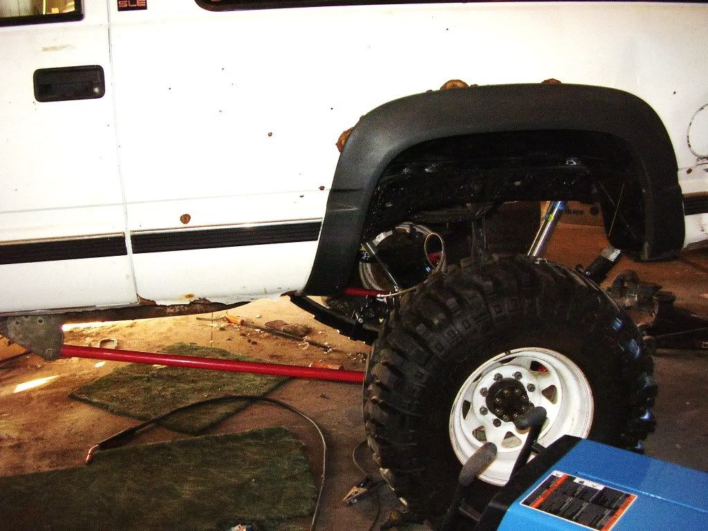

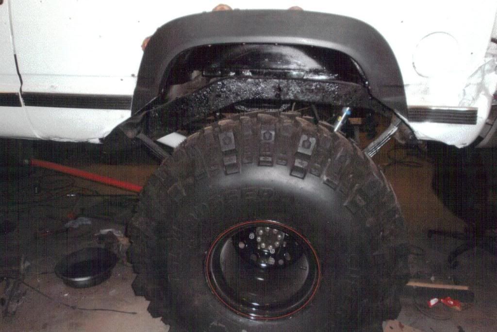

Rear Pull Point

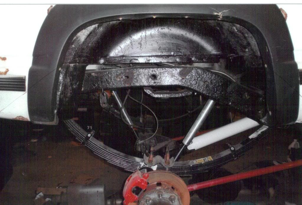

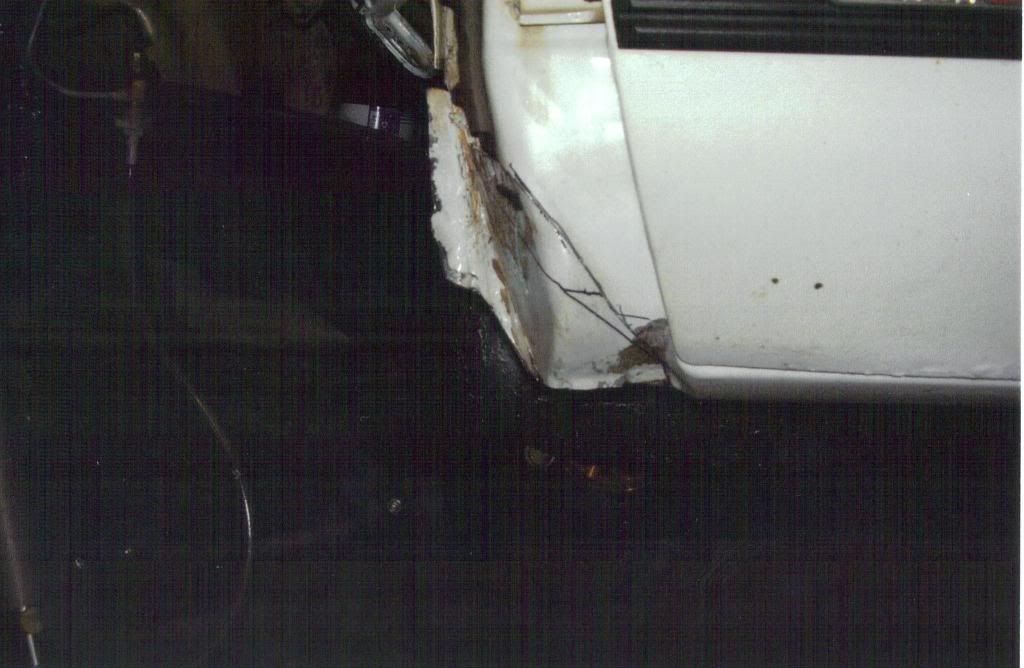

Before opening up wheel well
After

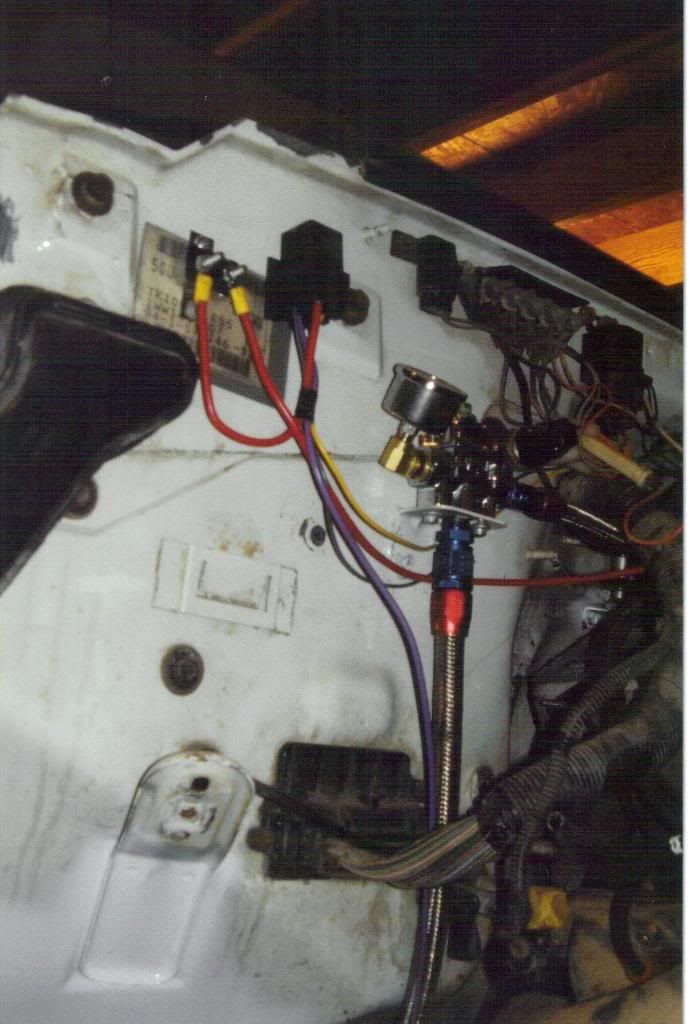

Fuel relay

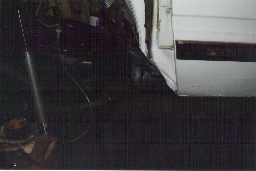

Front pull point
Before opening front up
After opening

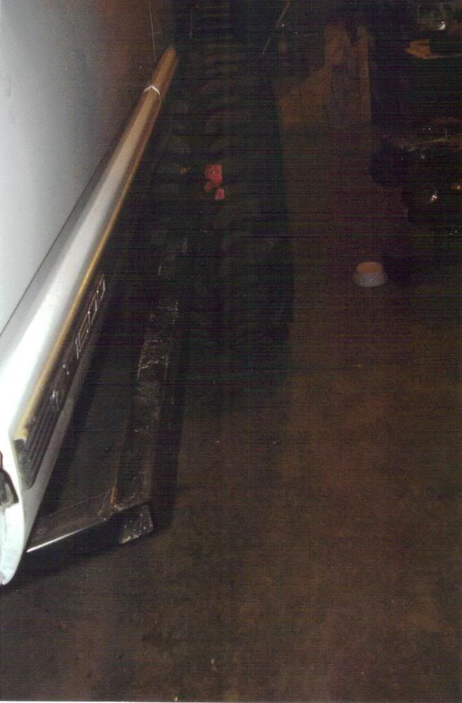

Side steps

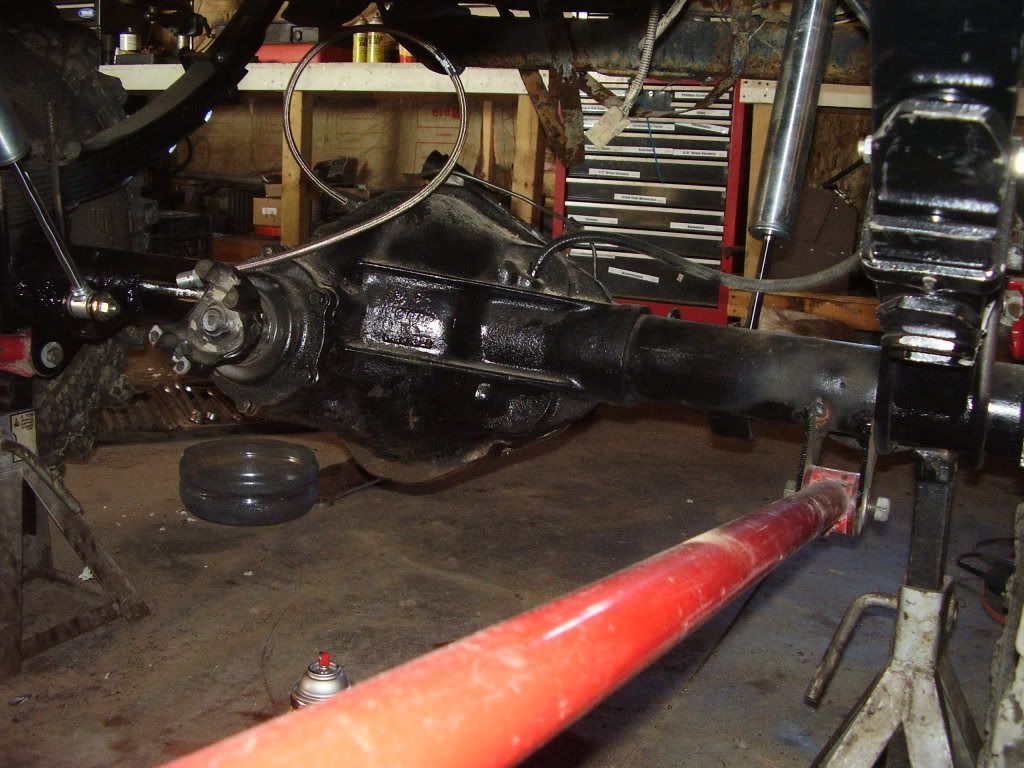

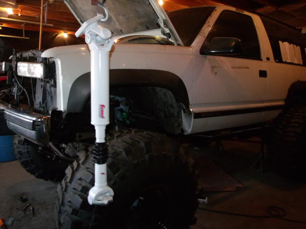

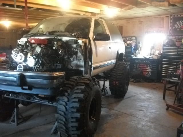

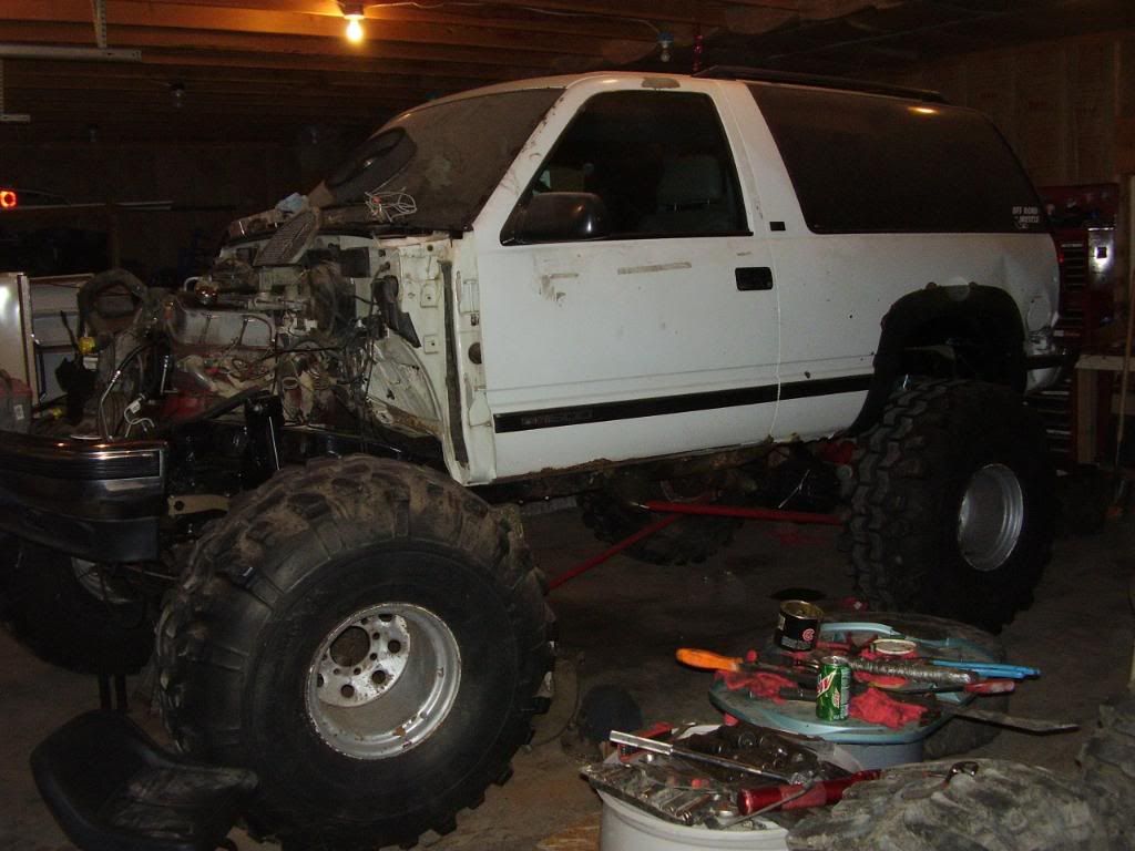

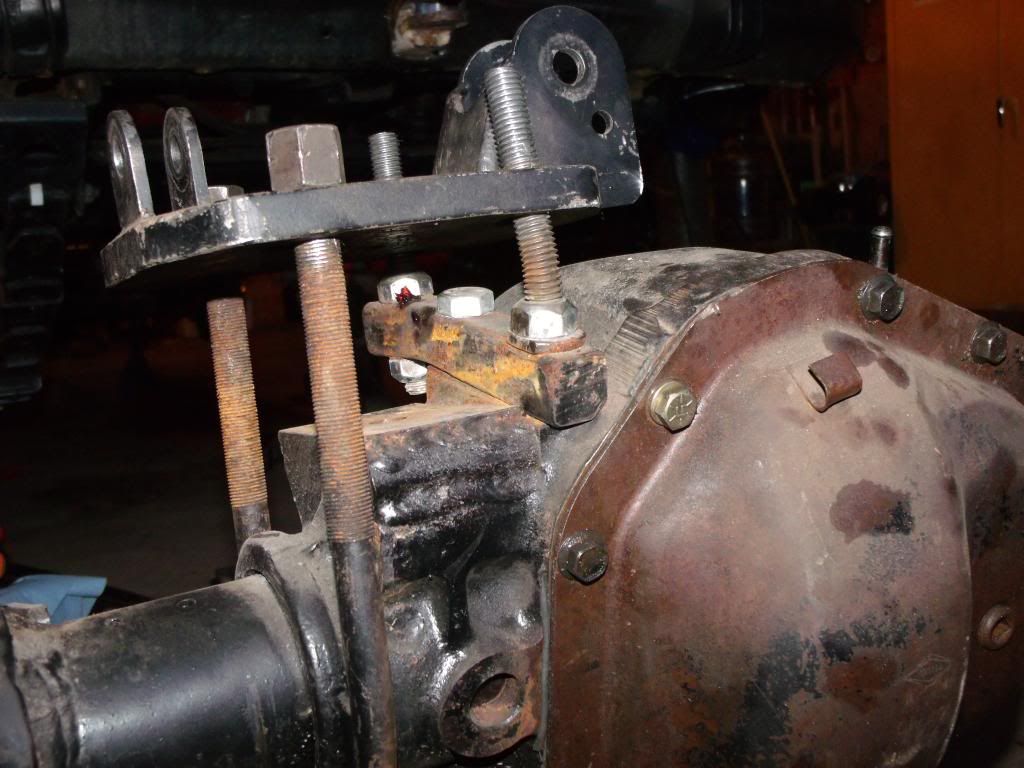

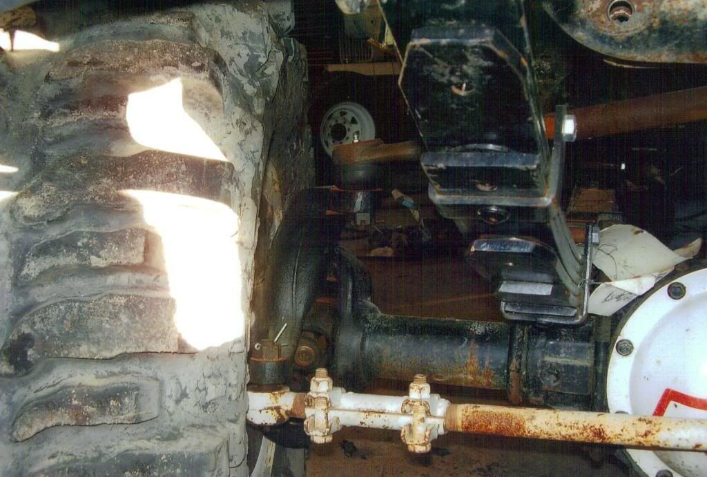

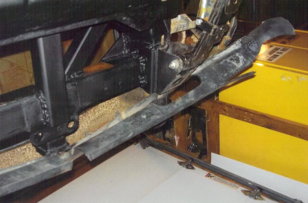

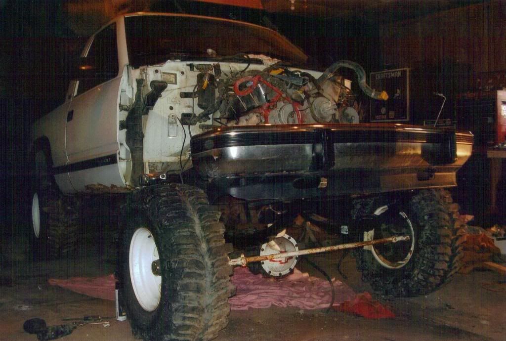

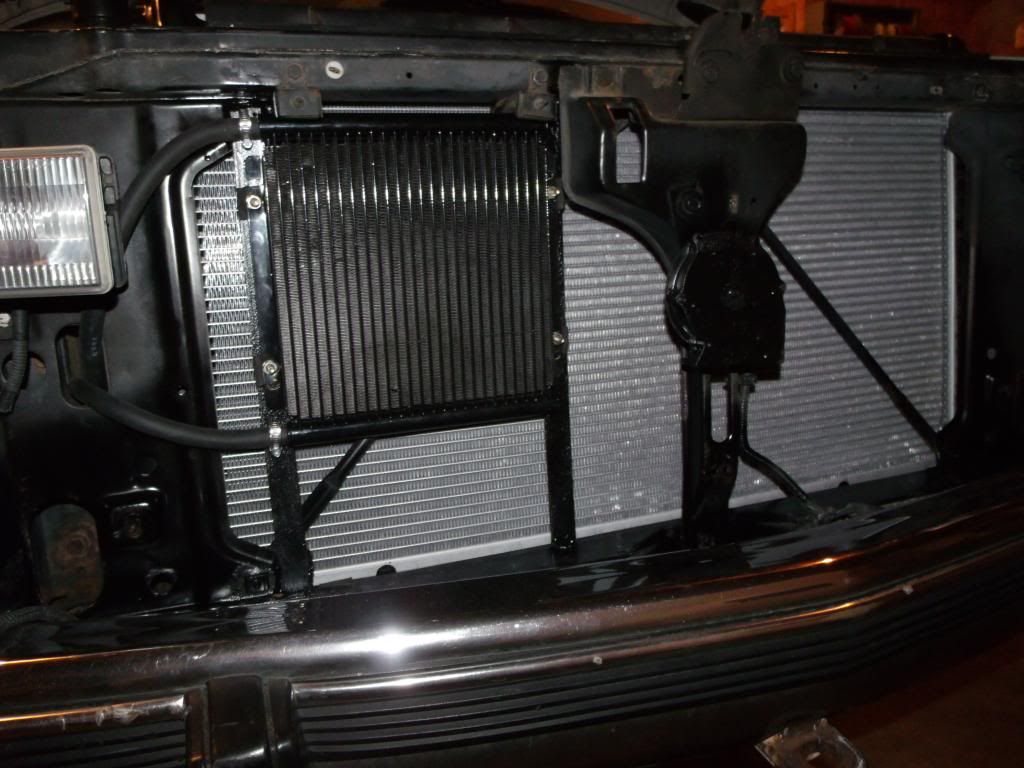

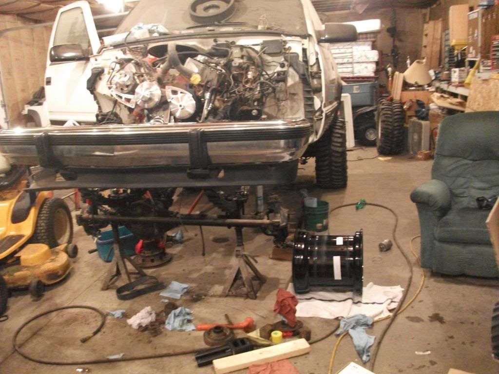

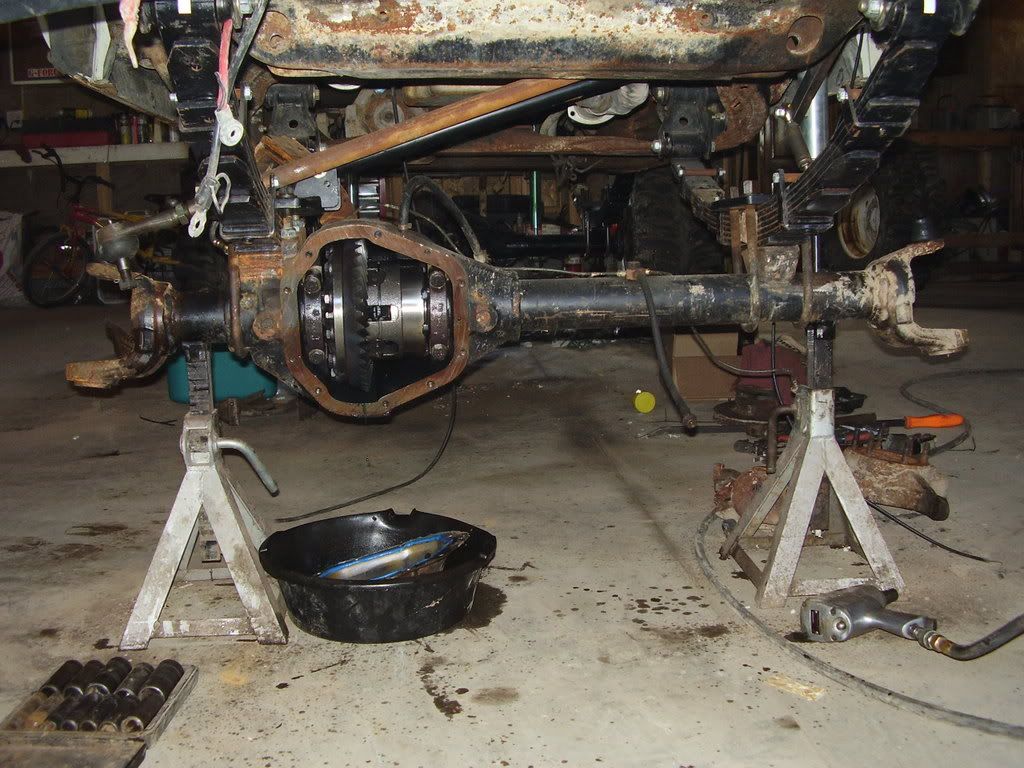

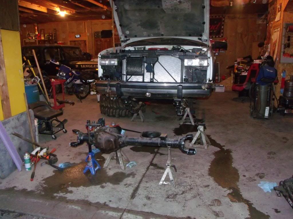

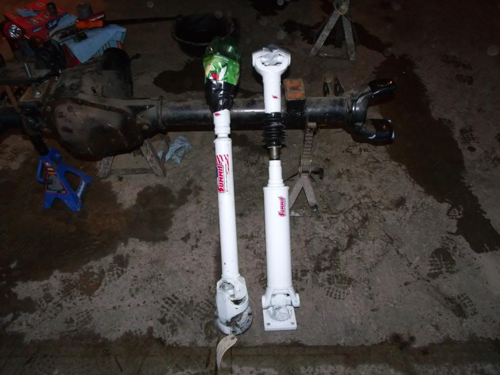

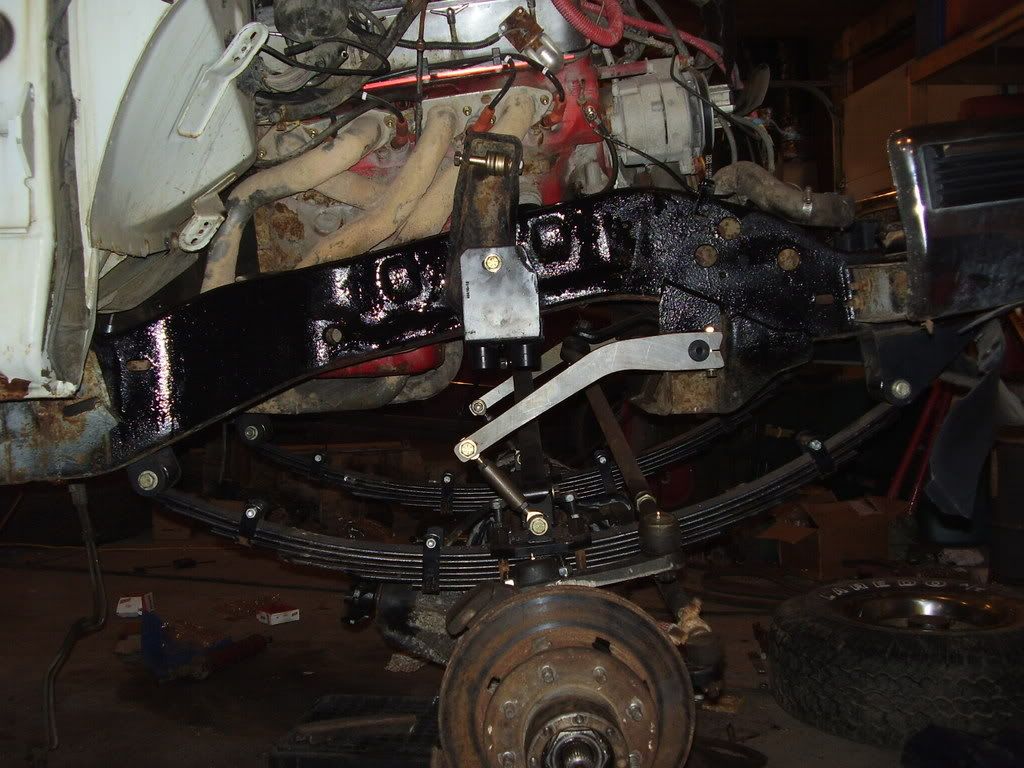

. Got front clip back on, raidator mounted, large trans cooler mounted ,engine chain down,battery mounted, front Bump to the top! stops in, cross brace over rear drive shaft notched an remounted, front drive shaft took out to upgrade to 1410 joints an got rid of double vilosity joint. mounted trans temp gage. ready for fuel if it only had a front end under it.  Sad Took it out, striped it to just a housing. Haveing housing milled an fab up mount to fix the two stud problem I had. O-so close  the DIRTIEST WEBSITE on the NET!

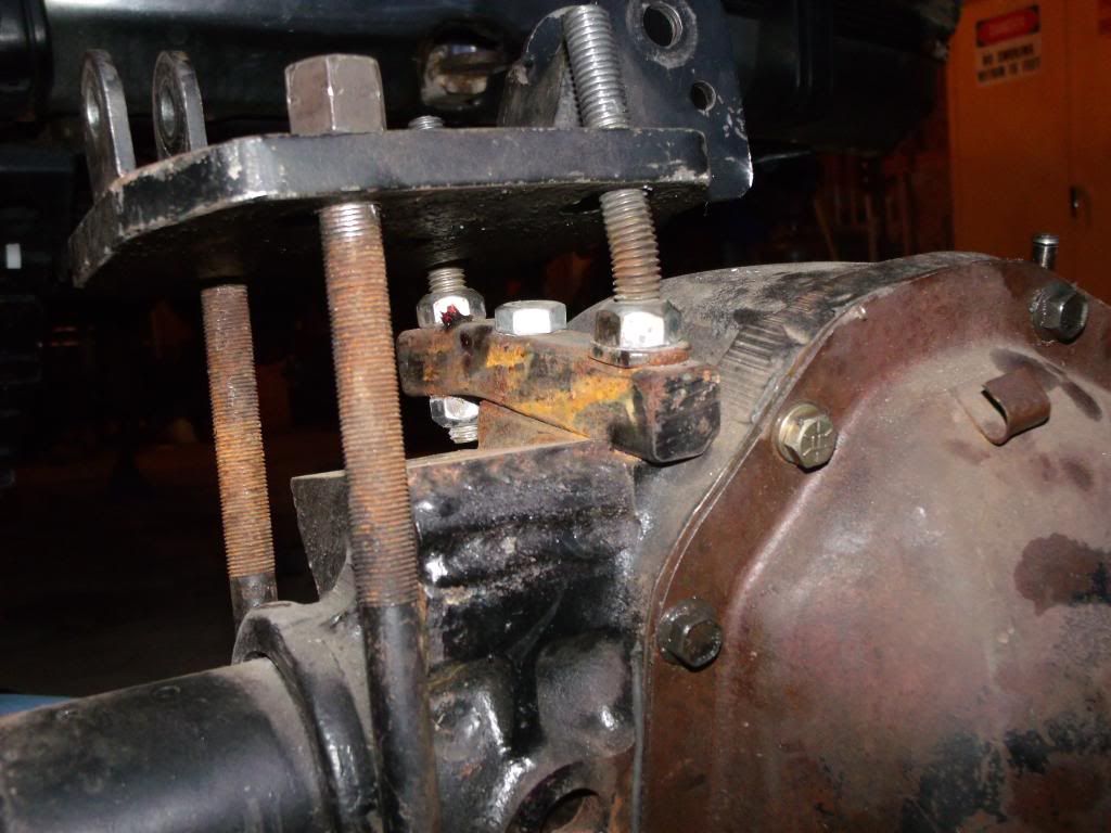

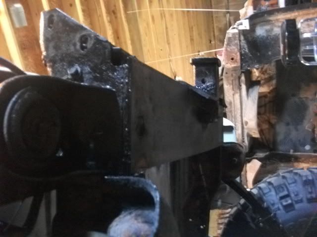

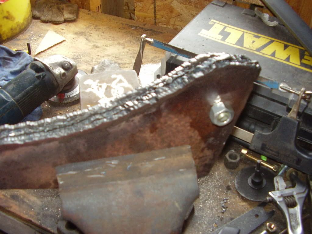

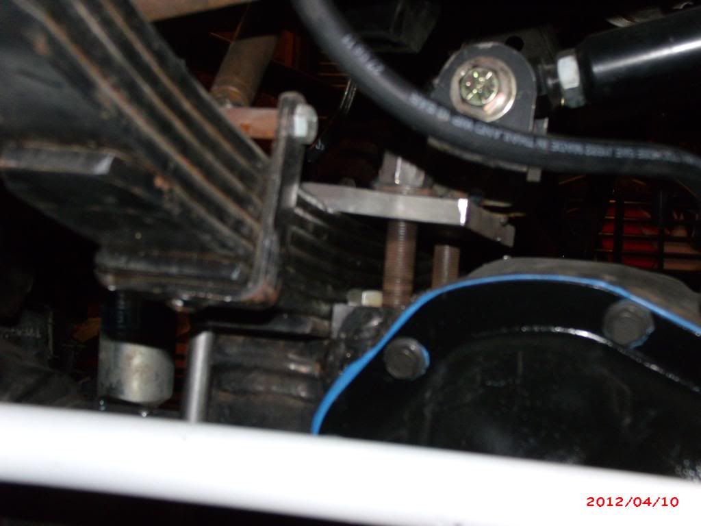

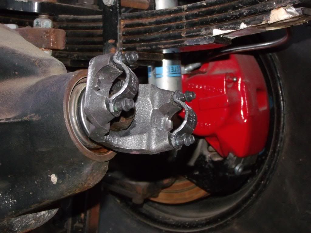

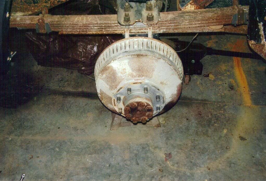

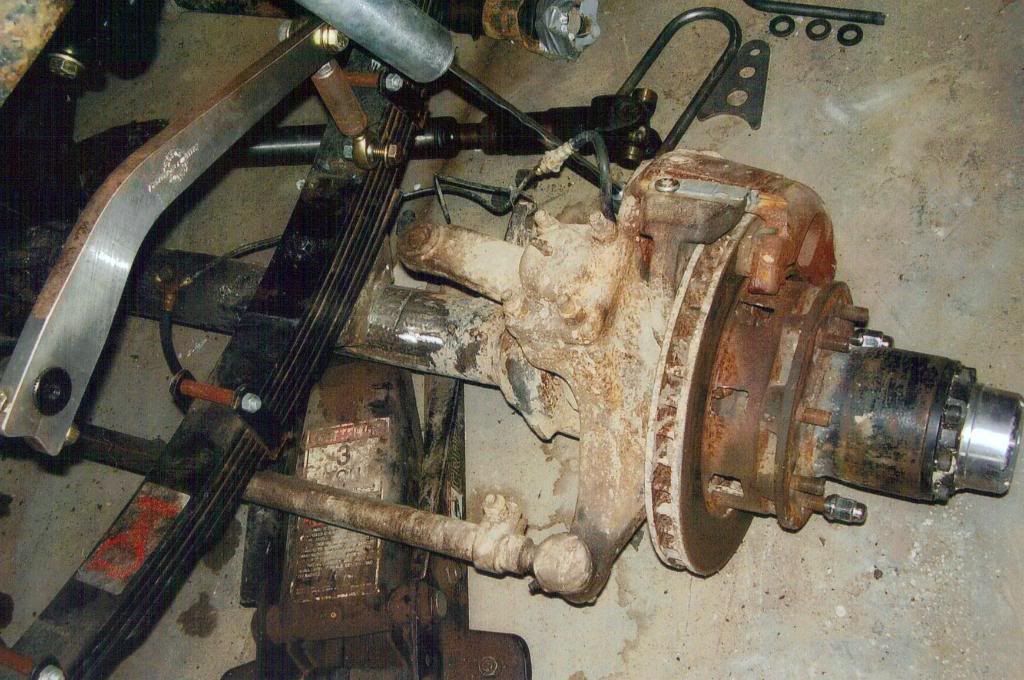

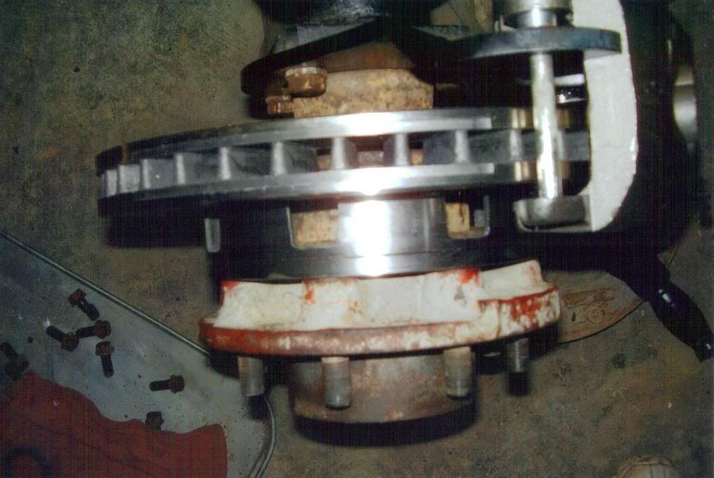

Axle had outers cut off - turned center section to limit some drive shaft angle - outers welded back on - shim welded on spring plate too fix sping angle - witch leaves the two studs at the wrong angle - this is how I got axle - if you see in pic they bolted square stock to axle at wrong angle and fixed by bending square stock in rear adding threaded rod- - front treaded rod in axle front stud hole - locked down square stock with nut - then bent threaded rod too fix wrong angle. This my have worked for them but I know it has been bugging me sence I got axle. I new I had to do something an never adressed it till now.  I'm Thinkin  will be strong when it comes back from its surgery

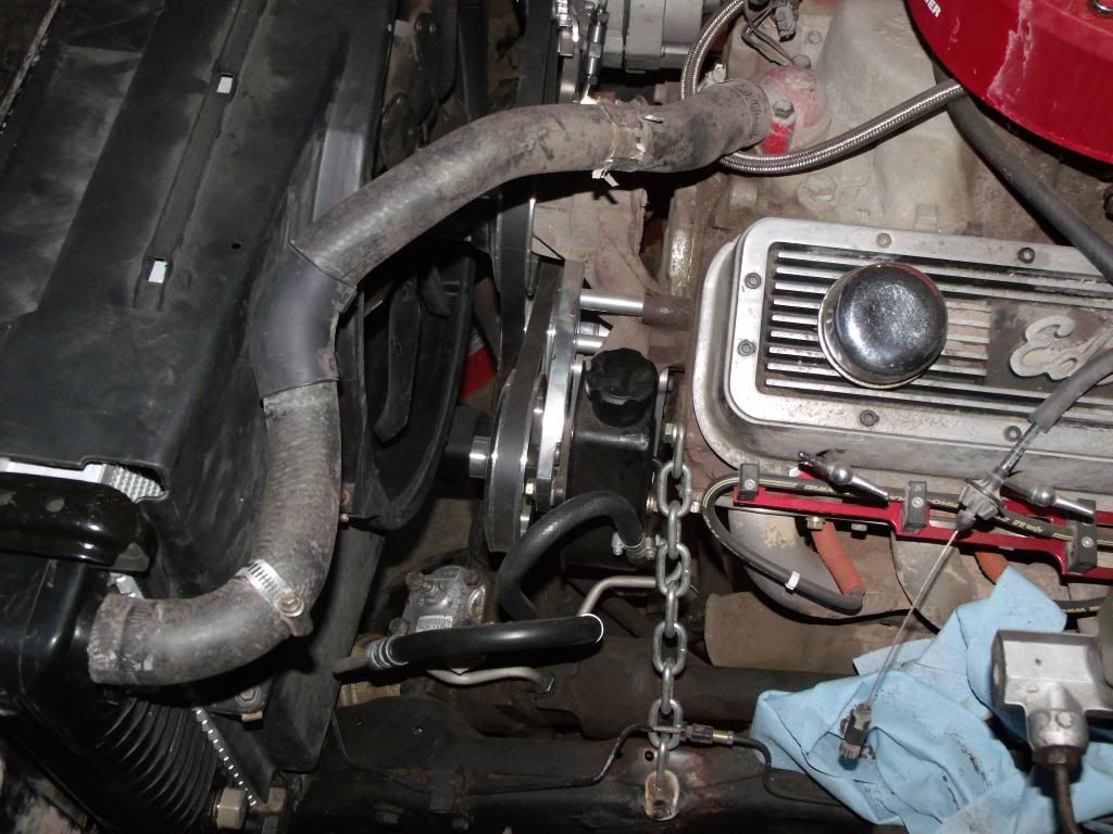

Chain -- is to do just that help limit engine movement chained both sides - headers are  really close on passanger side down by frame. Just figuered this would help things  Or crack my head  Who Knows? I  love all  input. Let me have it guys good or bad idea on chain ?

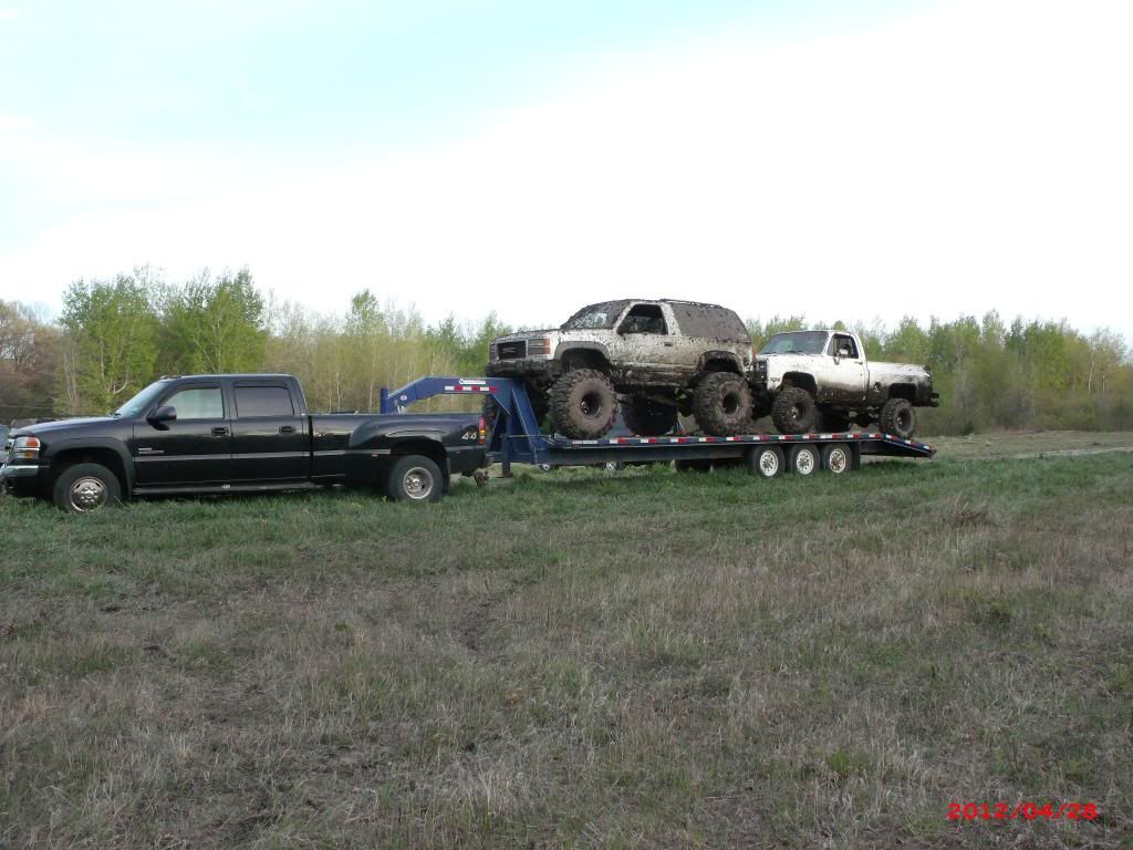

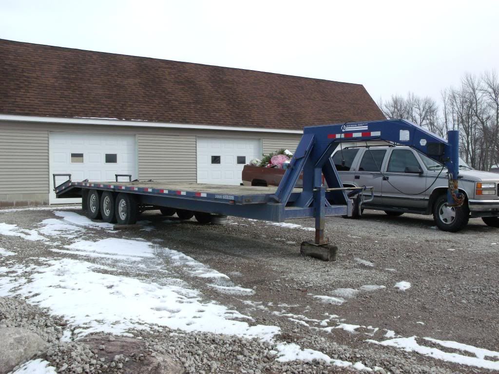

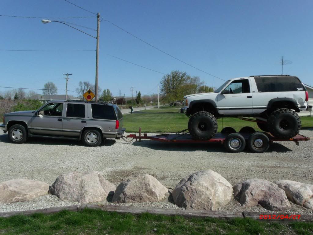

Got trailer to haul it now.  ==dancinbanana Now pressures on. Time to finish truck for TRUCKS GONE WILD

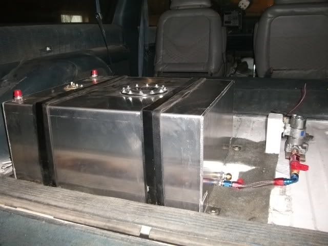

Well poured fuel  in fuel cell the other night. Only had one very small drip from a fuel filter. Got new one on the way. Fired engine up tonight. O such a sweet sound BBC. Still have to pull distr-cap to put new msd rev limiter cap on. Dam was it nice to hear it run. Love the new electric fuel pump ,new carb. fired engine with first turn of the key. Still have to set timing. replace drain plug seal on transmission pan its got slow drip.

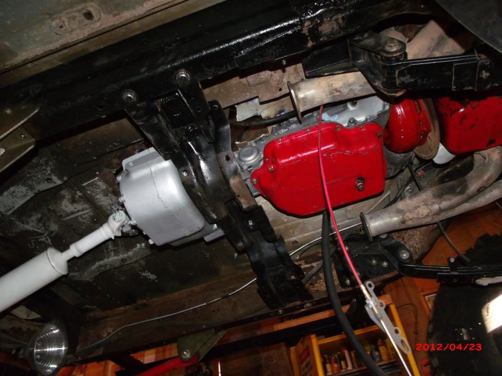

Got axle back an really like how stud problem was fixed turned out great. Not very good pics sorry. Got it all back together. Pulled it out to test brakes an feel it out.
First time moving under own power  VIDEO
Engine still needs little fine tuning set timing just right. was little anxious too have it move. LOL

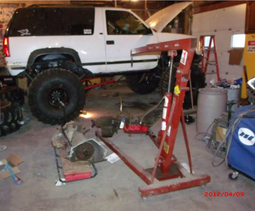

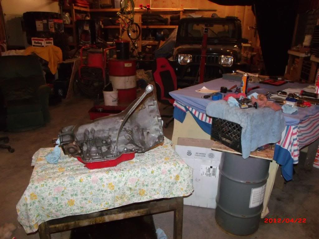

Test went very wrong.  :(  The only used part I put in this truck that was from someone elses word the transmission was a fresh rebuild my  ==kma How some poeple can do this. all I can say is he is lucky I deleted that pm i don't remember his name.

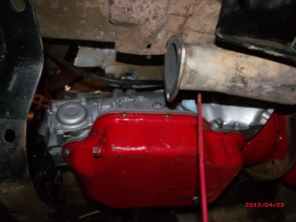

Trans back out Doing a complete B&M rebuild with bran new Hursh 3000 stall converter Hope to have back in by Thursday for exhaust to be welded in Flowmasters with 3"

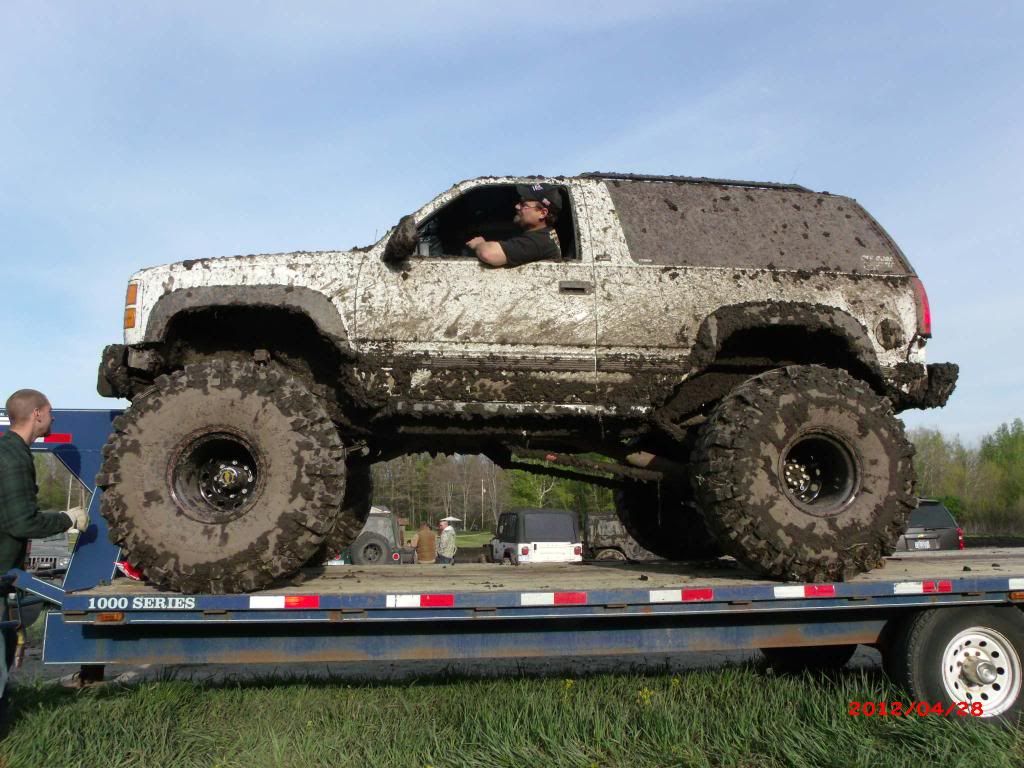

Loaded on way to get mufflers 3" flowmasters

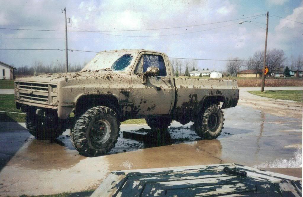

Got Mud!!!!
Father an son Great Day!
All Cleaned up

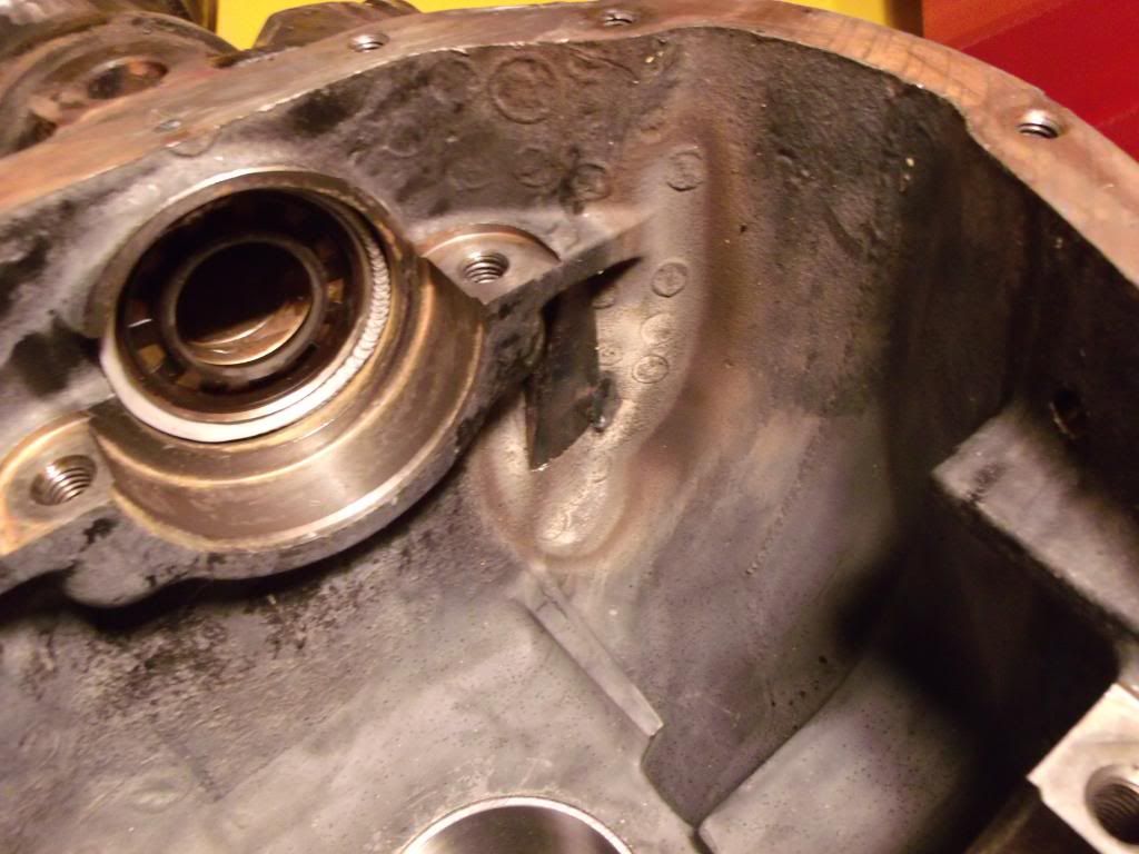

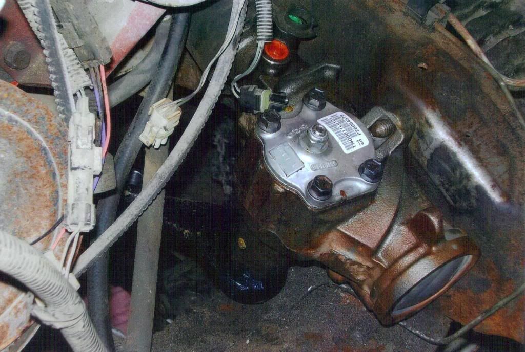

Now the Bad  ==sick trans was not working like it should never had first gear an I think I fried second. Taking trans back out too find what went wrong. Steering did not work. Could not turn very sharp with way steer box is Going hydraulic steering.

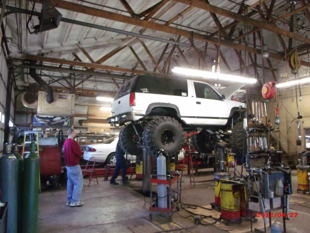

May 2 2012                                        Sticks of Rome - Trucks gone wild 2012
Fixed trans had to block a hole in valve body. Was running with 1st an 2nd sharing fluid. Had a flawless week end truck ran great all weekend. Got to finish them wiper blades now LOL sticking arm out window with a window washer stick works still a pain. Made TGW  2012 Priceless weekend.

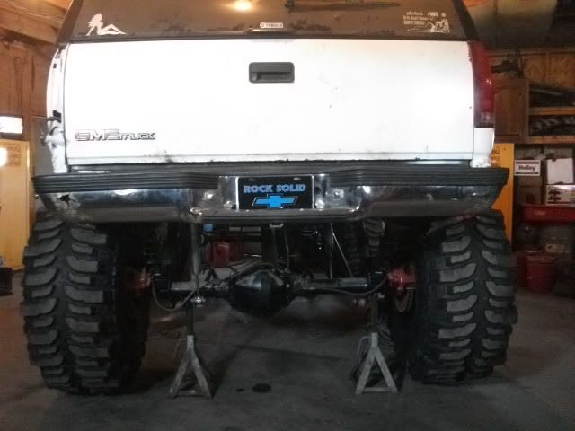

Well after getting it cleaned up. I found I bent both rear main leafs an ripped one rear spring pocket and caved in body mount pokets. I was thinking mud was why it was sitting little lower in the rear. I was wrong. New I should have got them rear bump stops put in.  loll

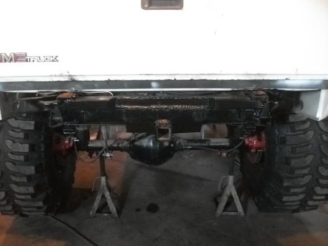

 woho   New Hauler  woho
          99 3500 4x4 454
Went to get box line-x an they said they were going to have to sand an prime bed first. Was out rages price did not do just put new goose neck hitch in bed. Have to wire truck for trailer yet.
June 24 2013
 Well its been to long I know. Still sitting on stands. Started hyd steering an just going to put new 4:56 gear in front no funds for changing to 5:38 . Had to stick a boat load of cash in too hauler front end all rebuilt ready to haul now.

2013 TGW Hale  Back to the drawing board bent both new rear leaf spring for second time.blown out both rear shocks springs resting on body mounts.

++peace installed heavy duty rear shakle flip. Grinding pearches off to fix drive shaft angle. ready to slide back under truck and weld new pearchs on. have to fix wiring going to starter an change starter. wires all fryed going to it. Got hot by headers

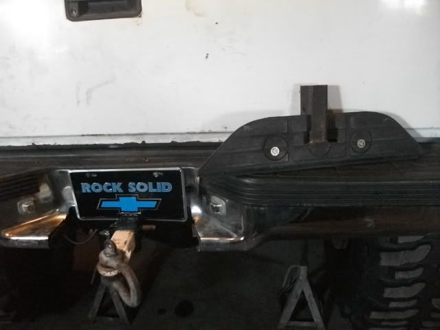

(2016) Truck got  bran new rear leaf springs, Big shock bump stops in rear ,Rear water tank sprayer for windshield.
MMJ 2016 Ran the p00 out of it till i started hitting a big jump harder an harder. Till i cracked the transmission and bent the new rear leaf springs. Riding on new Big shock bump stops now and Bleeding transmission fluid
